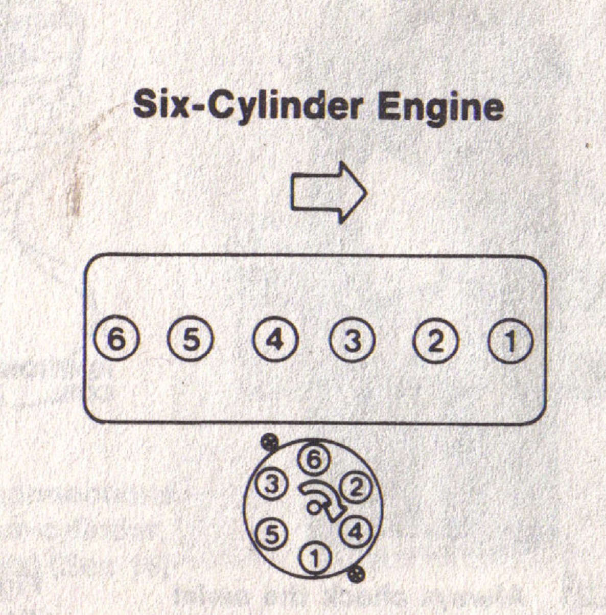

If it ran fine, then your changed all plugs, coil and wires, then it wouldn't run, I'd think that either the plug wires were wrong, or that you had a new, bad coil.
Any chance the cap could be on 180 degrees out?
bet you put wires back on wrong heres a diagram so you can go back and double check
