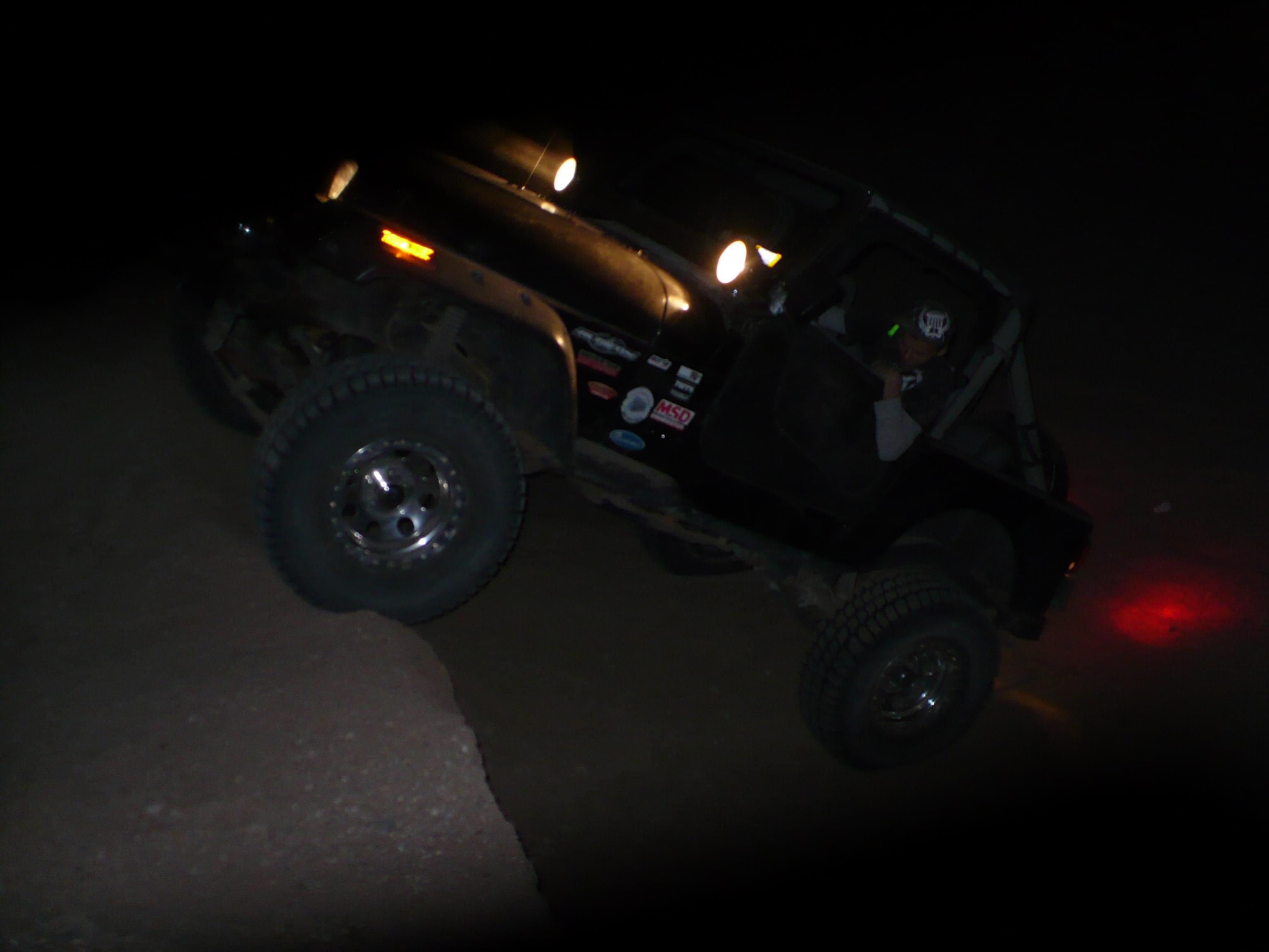

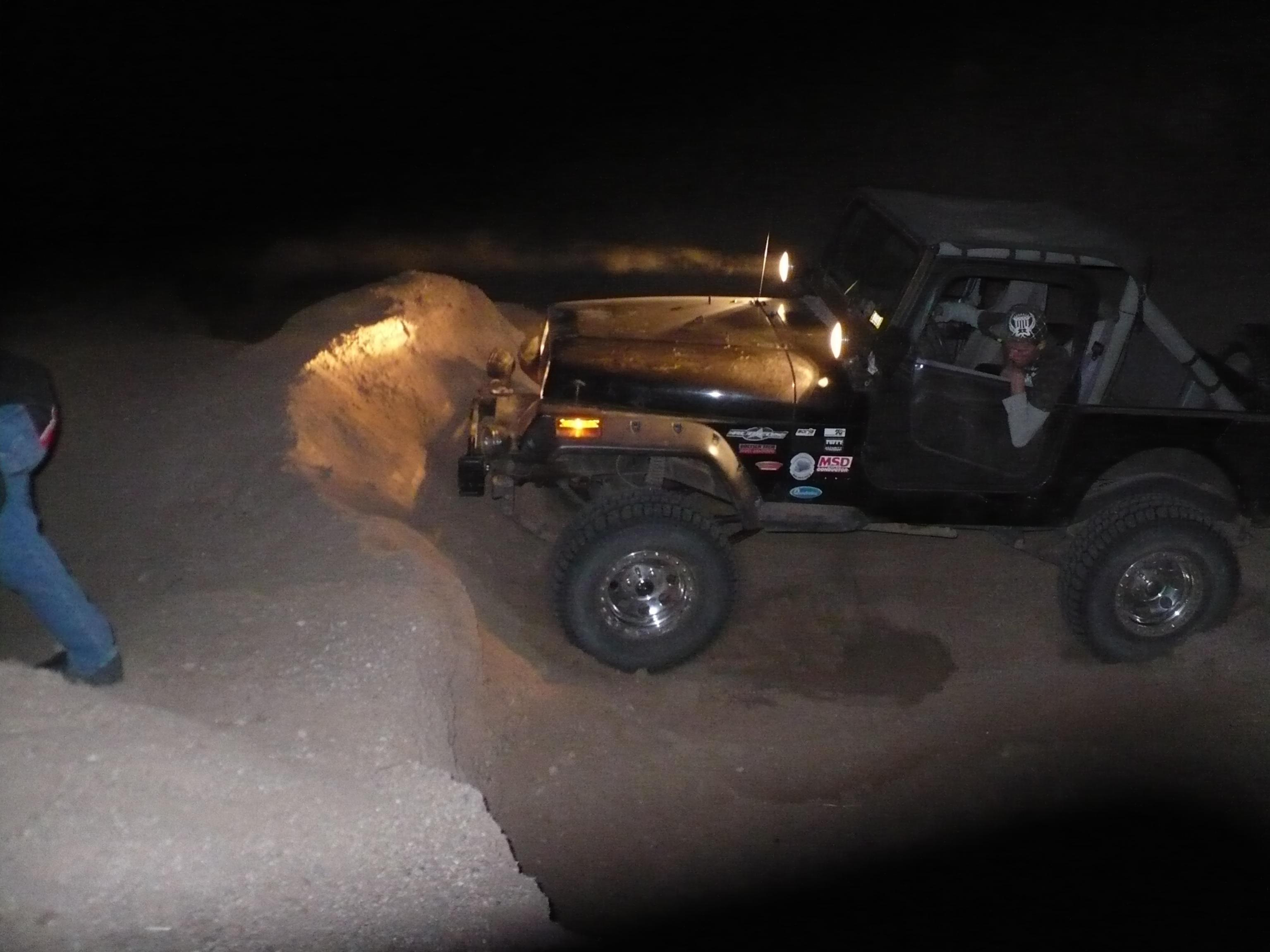

ok i have an 88 yj that i'm starting to fix up. the setup it has right know is a inline 4, i think the stock transmission and transfer not to sure, a 4 in rubicon lift, 35 in M/T on M/T classic locks, 5.13 gears in rear w/o a locker in the stock axels.
i'm going to get a chevy small block 350 to put in it, but i'm haveing trouble finding a good transmission to go along with it. so i'm wounder what would be a good set up for it.
plan on putting dyantrac 60 in rear w an ARB locker probly same gear setup, Dyantrac 44 in the front, and an atlas transfer later on.
