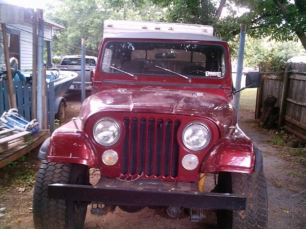

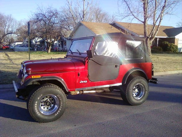

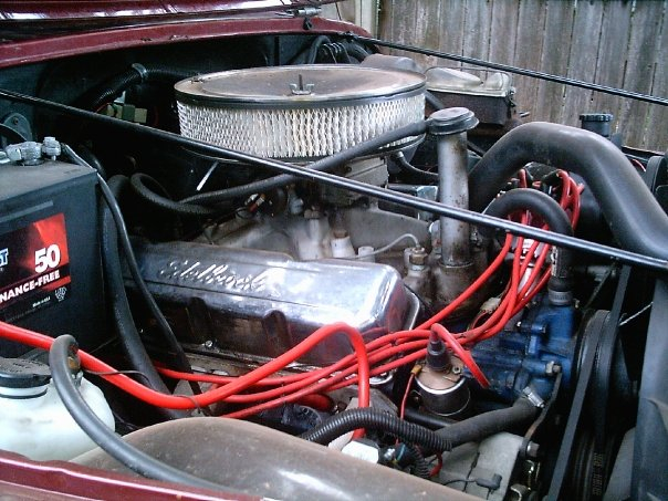

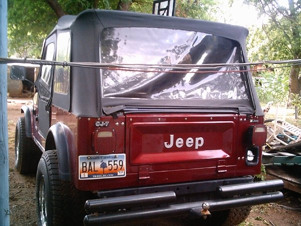

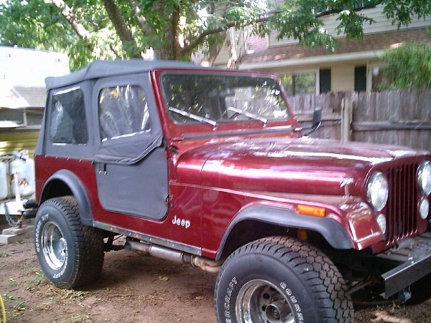

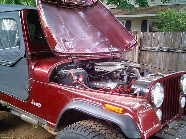

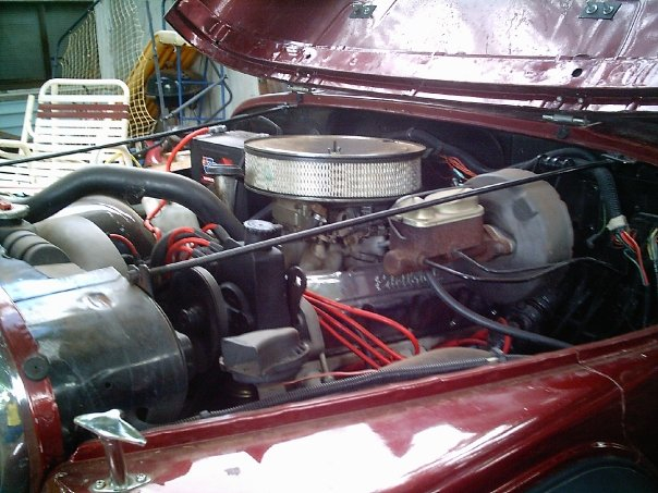

I have this CJ that currently has a 360 bored to a 408 that I'm wanting to downsize the motor and I've never done anything like this it does have an automatic transmission. How hard is it to convert it over? PLEASE HELP

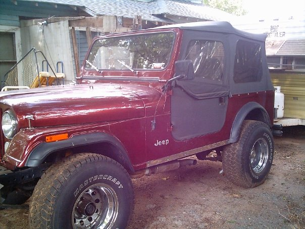

This is the CJ we are talking about

grab a dodge 727 transmission bolt right up to the 360 there stong enough to stand behind my old 5.9 cummins
What are you wanting to do? Are you wanting to swap the engine out for a smaller cube engine? or one not as built as your current. If so then that is easy to do with the AMC engines. the 6cyl and 8cyl egines share the same trans and bellhousing, so either engine will bolt right in. If you go V8 it is a direct bolt up, if you go 6cly you will have to change one motor mount (drivers side I believe)
