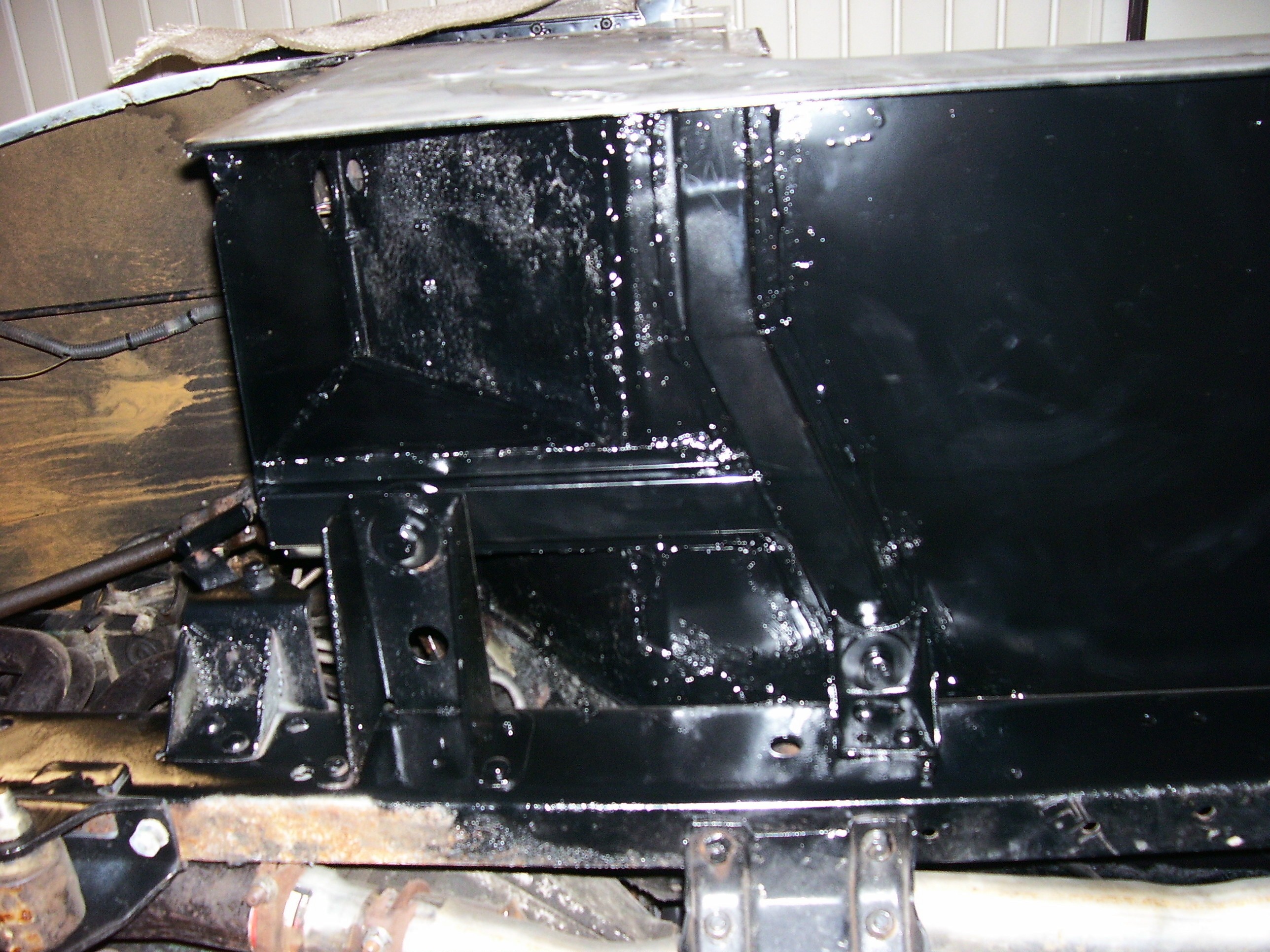

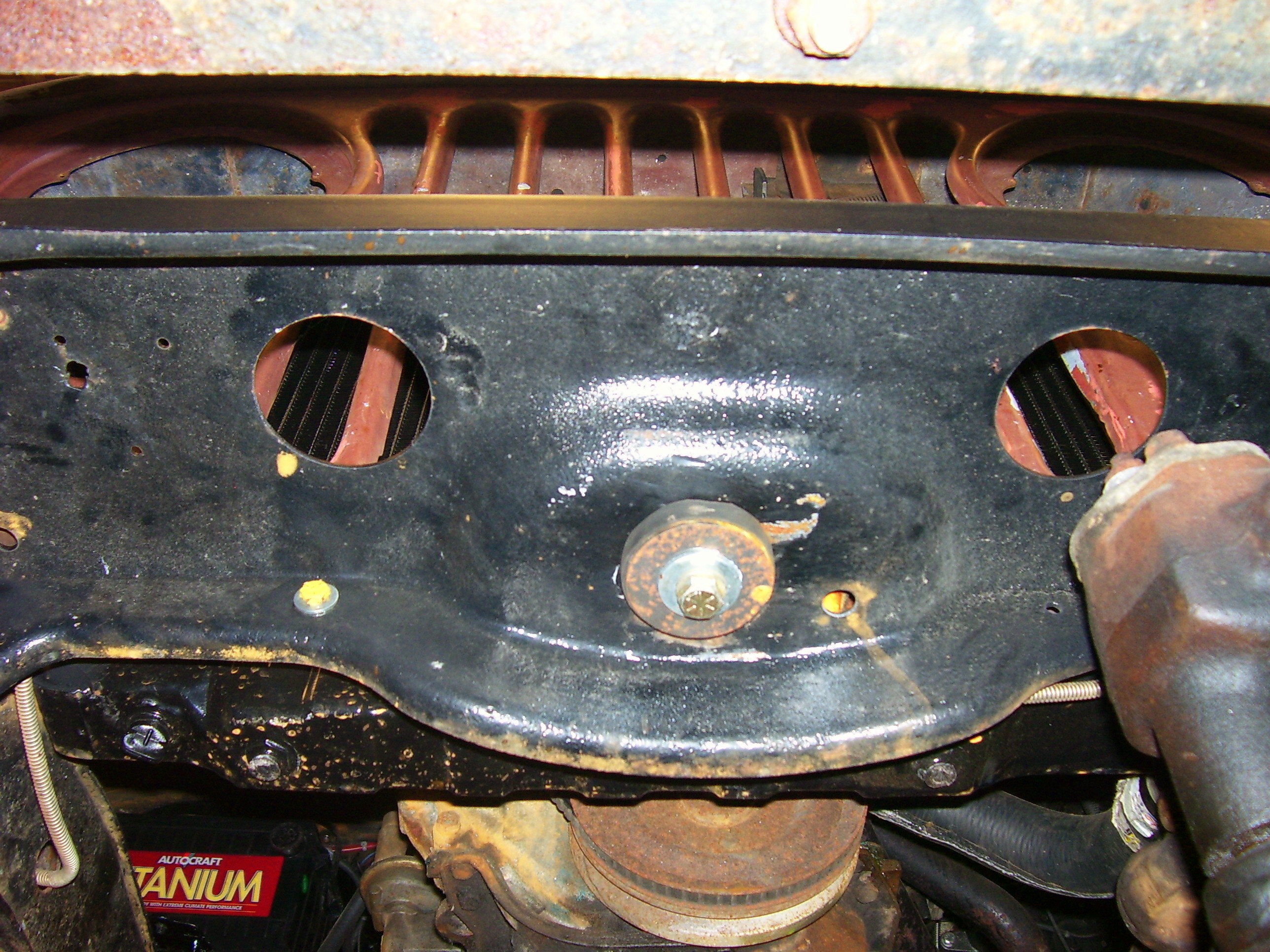

The 1st pic is the front core support, the main reason I took the Jeep to him in the first place. It was not there =P and the hole to put it in, in the cross member was not there either (wtf?) still cant explain why. Did the PO replace the front cross member? And if so, why? Anyway, this was causing me LOTS of problems, as you can probably imagine! I wont get into that now.

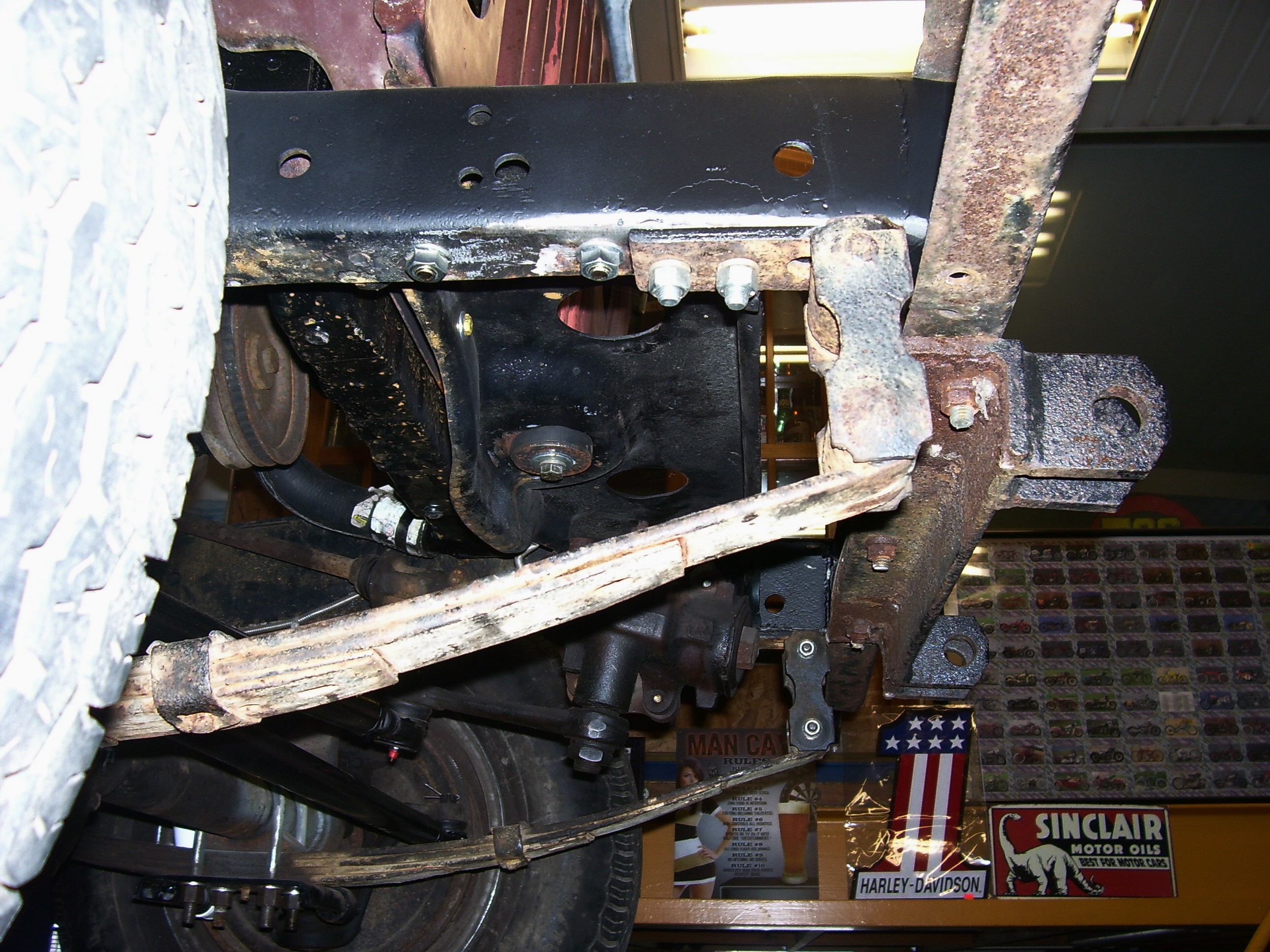

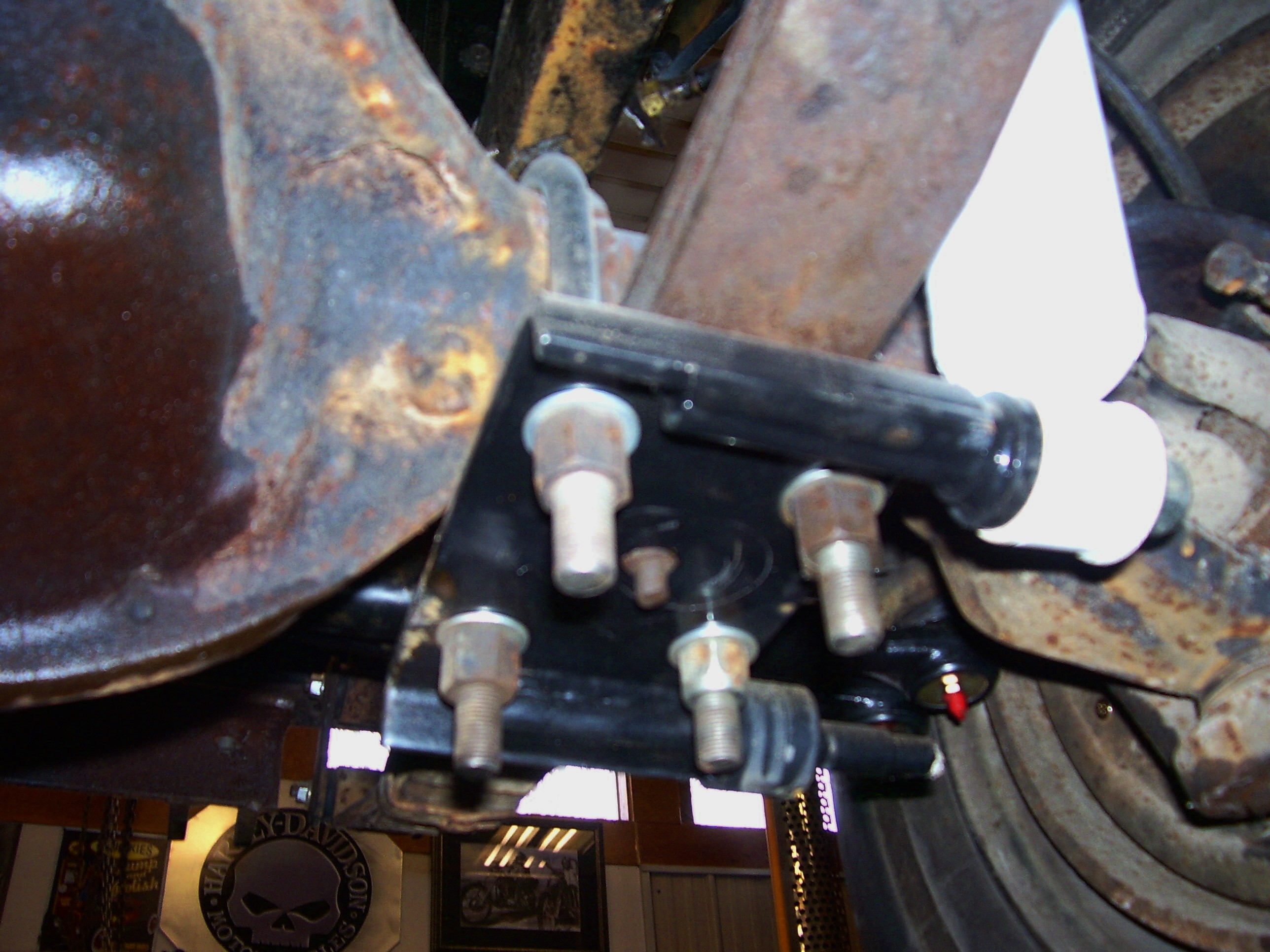

The second pic we replaced the 75 spring (hanger?) and upgraded to 76 and up. Bought some used springs for now. He had to extend the horns to accomodate this mod, and Im not completely sure that the placement is correct. Any feedback on this issue? Its the only questionable work he has done...

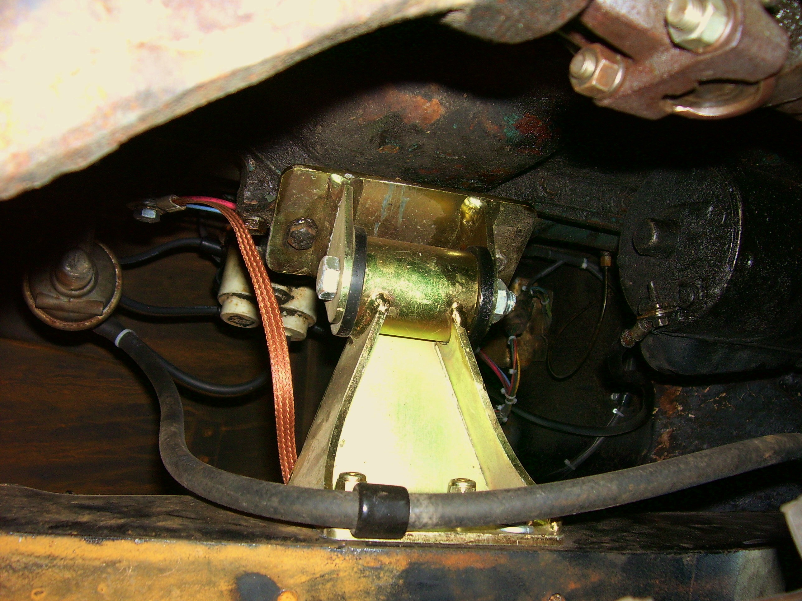

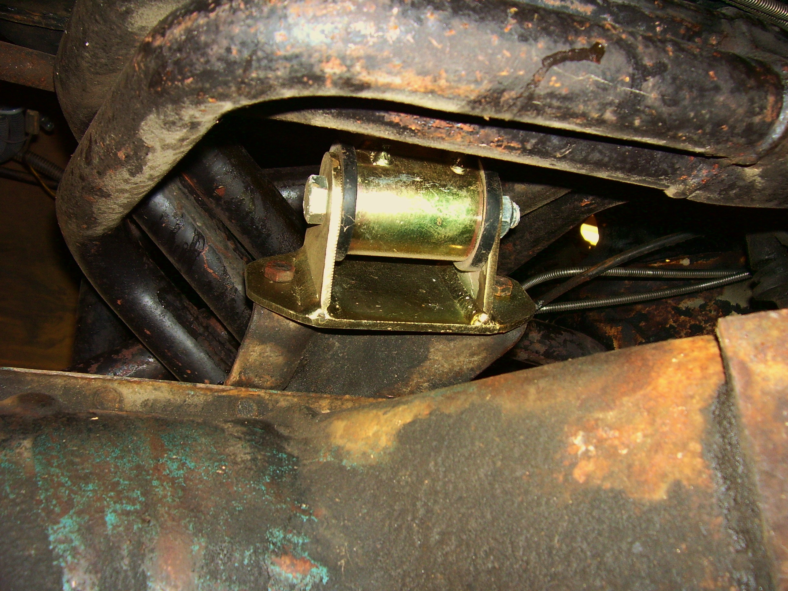

Included pics of MORE bombproof motor mounts (I actually did that job myself!) That was one of my first mods, due to a broken mount, probably caused by the terrible angle of the motor from the former Spring over mod.

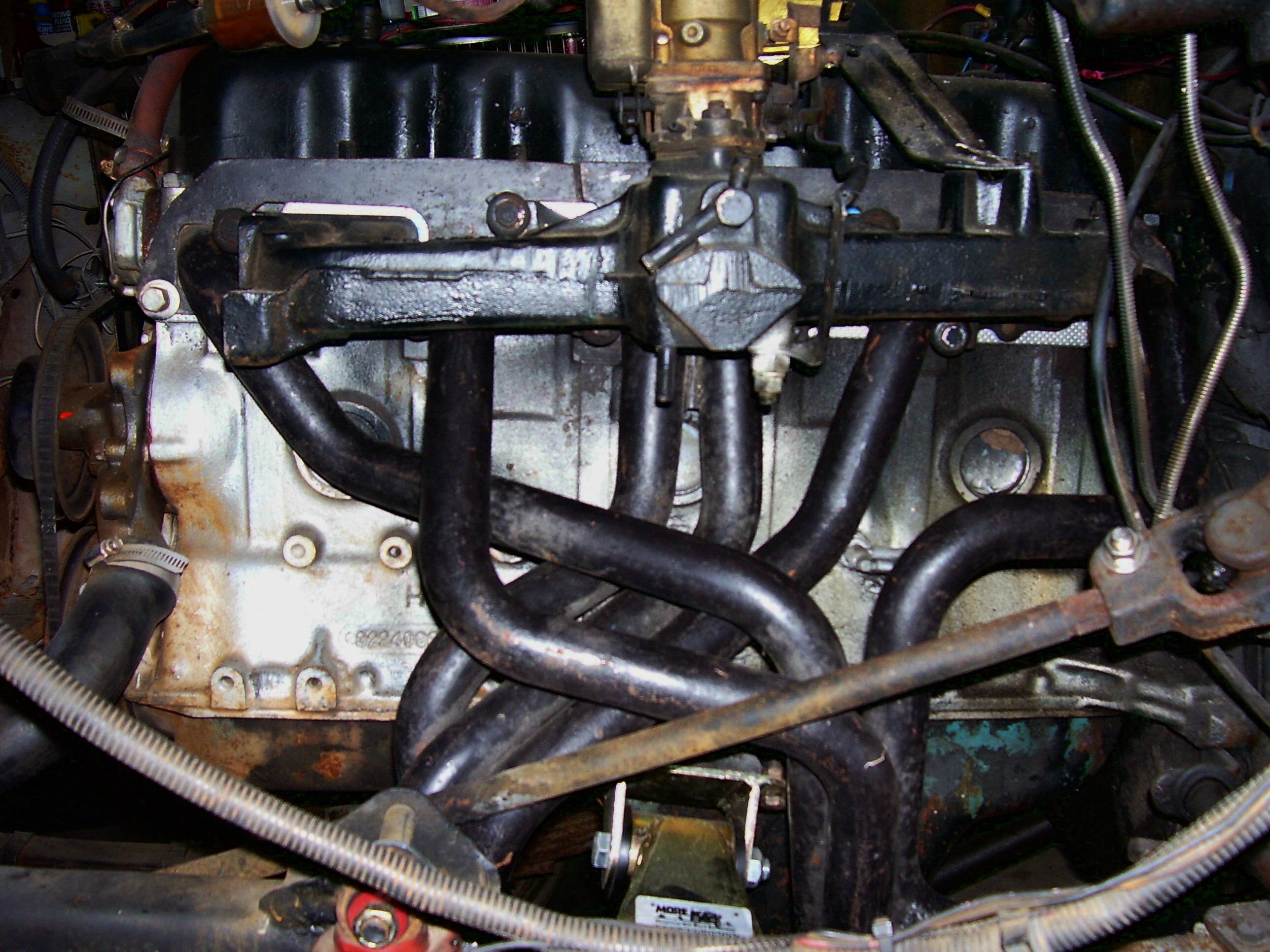

Heres a pic or two of the headers I installed (yes "I") I am proud of these repairs since before I owned this Jeep, I never even did an oil change myself.
I had to replace them because the old ones had a hole worn into them, from the steer (shaft?) again due to the angle of the engine.
I am not a mechanic, so my lingo is sometimes off. Bear with me.

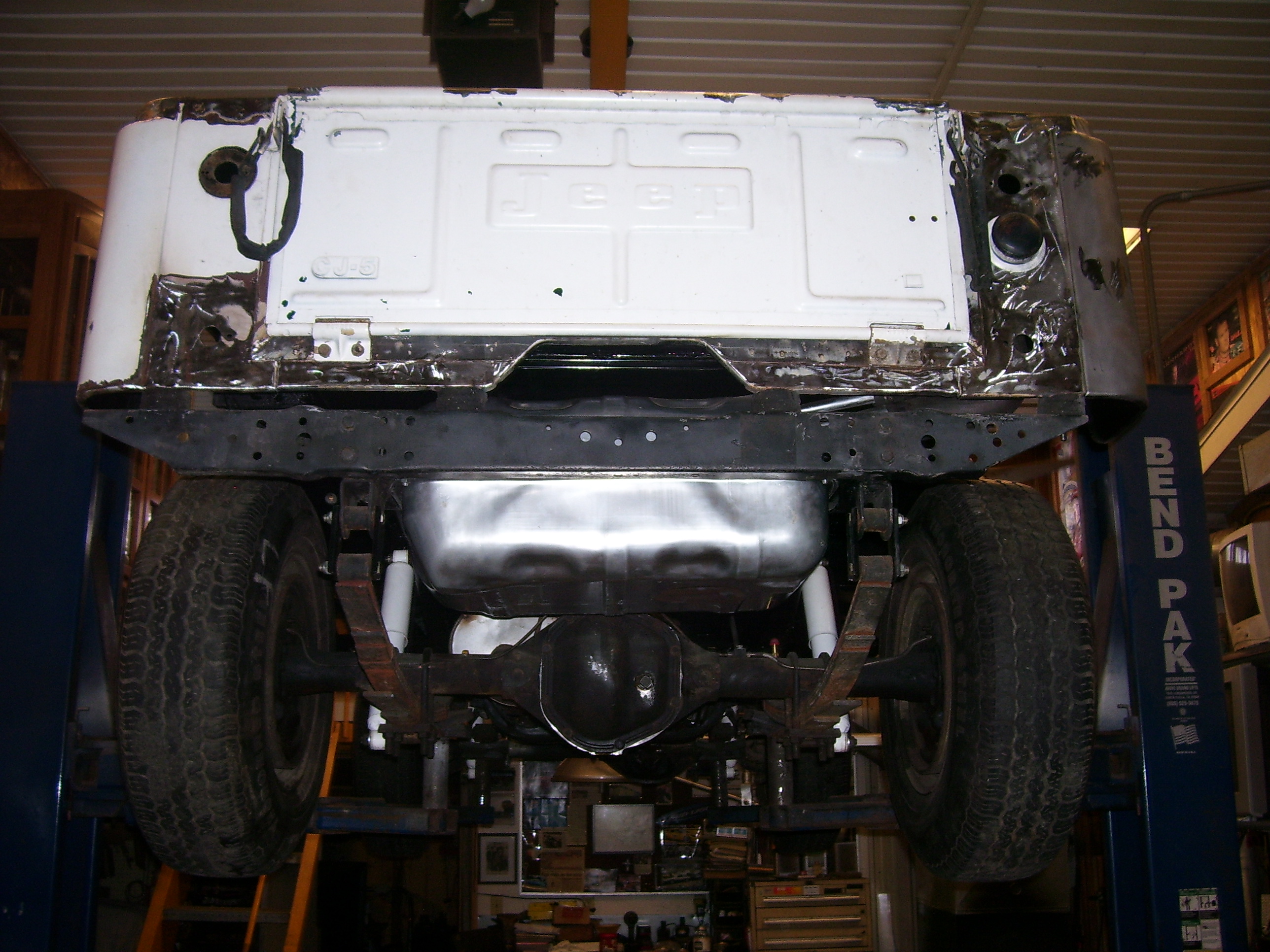

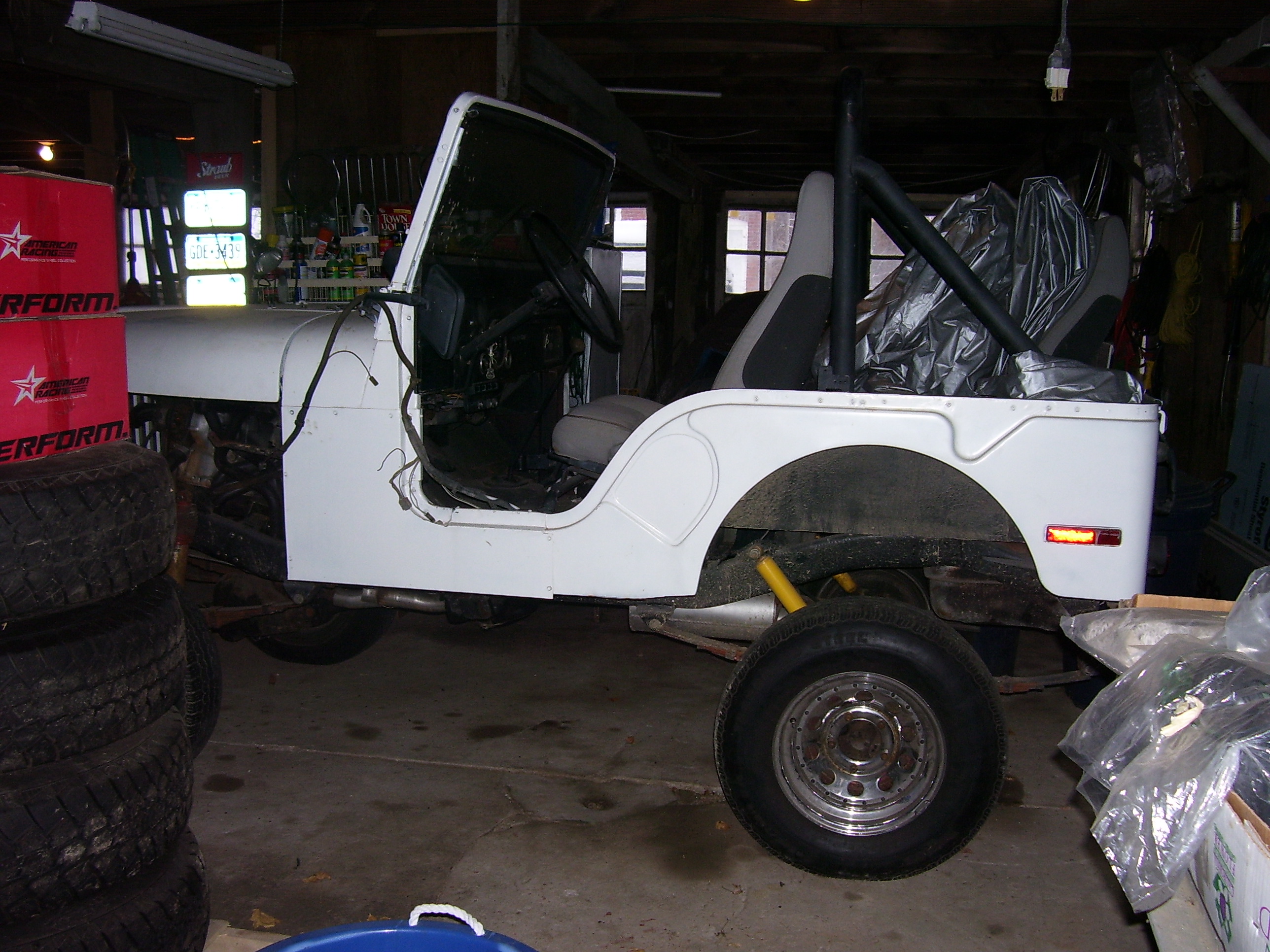

New fuel tank installed. You can also see in this pic the tailgate and left far rear corner panel. These are pretty much the only original metal left from the cowl back.:shades:

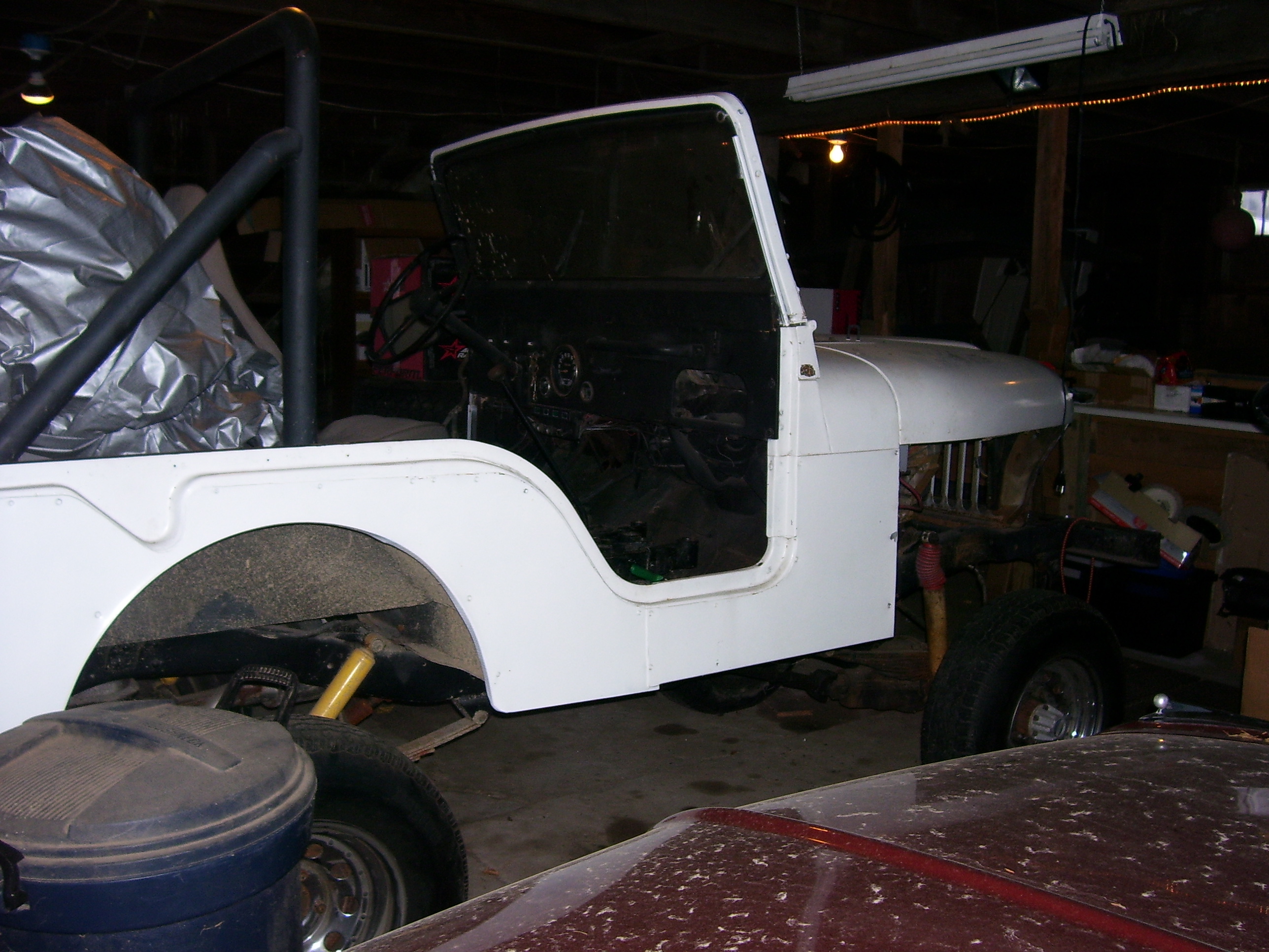

Heres a couple b-4 pics of Frankenjeep...
The PO put replacement sheetmetal on over the old rotted panels with sheetmetal screws, and smoothed it out with some kind of plyable body putty. (what a mess)
Oh, and theres some kind of "repair" to the lower inner windshield frame that covered a hella mess, and there wasnt anything holding the windshield upright except the bikini top!

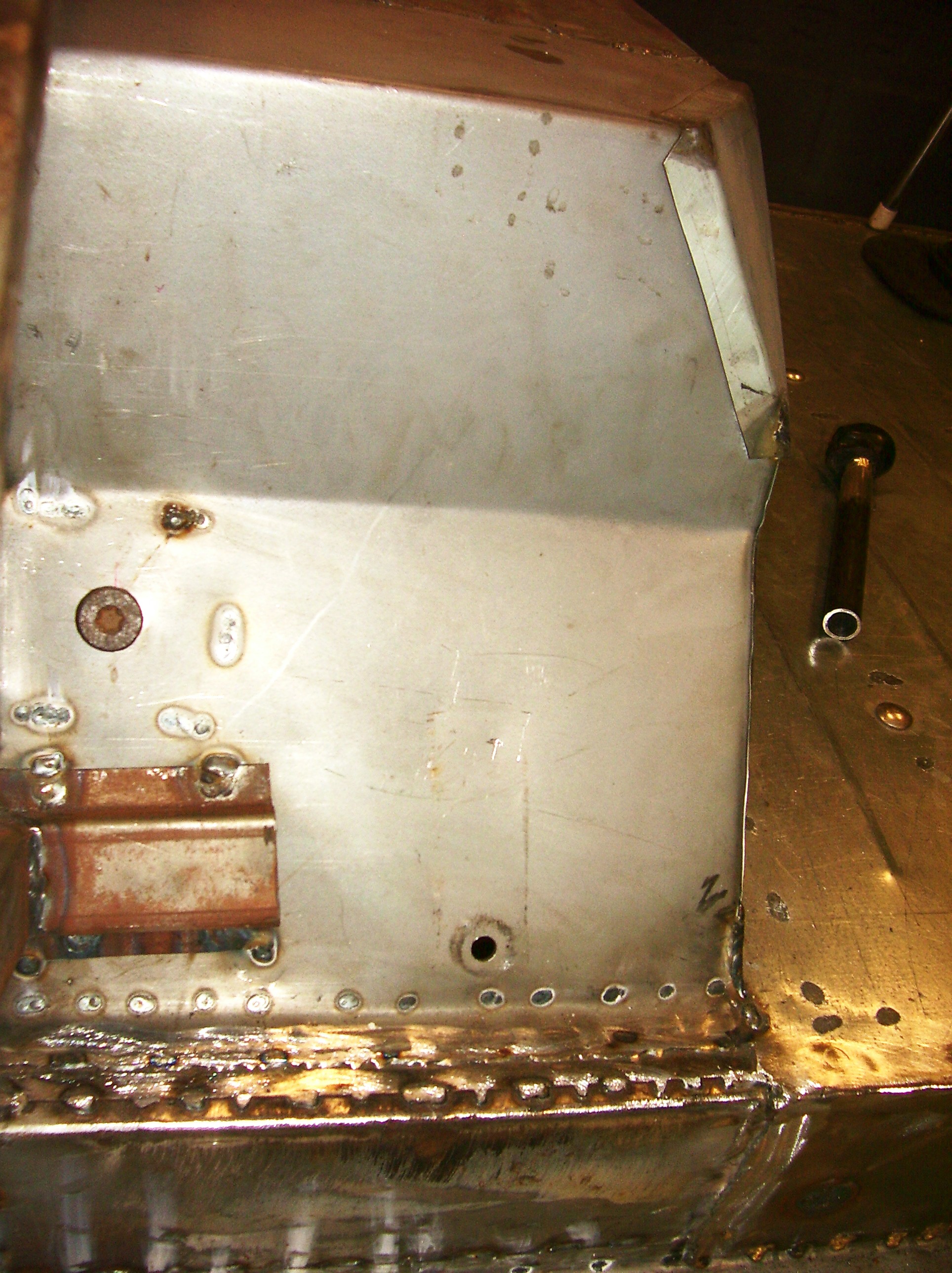

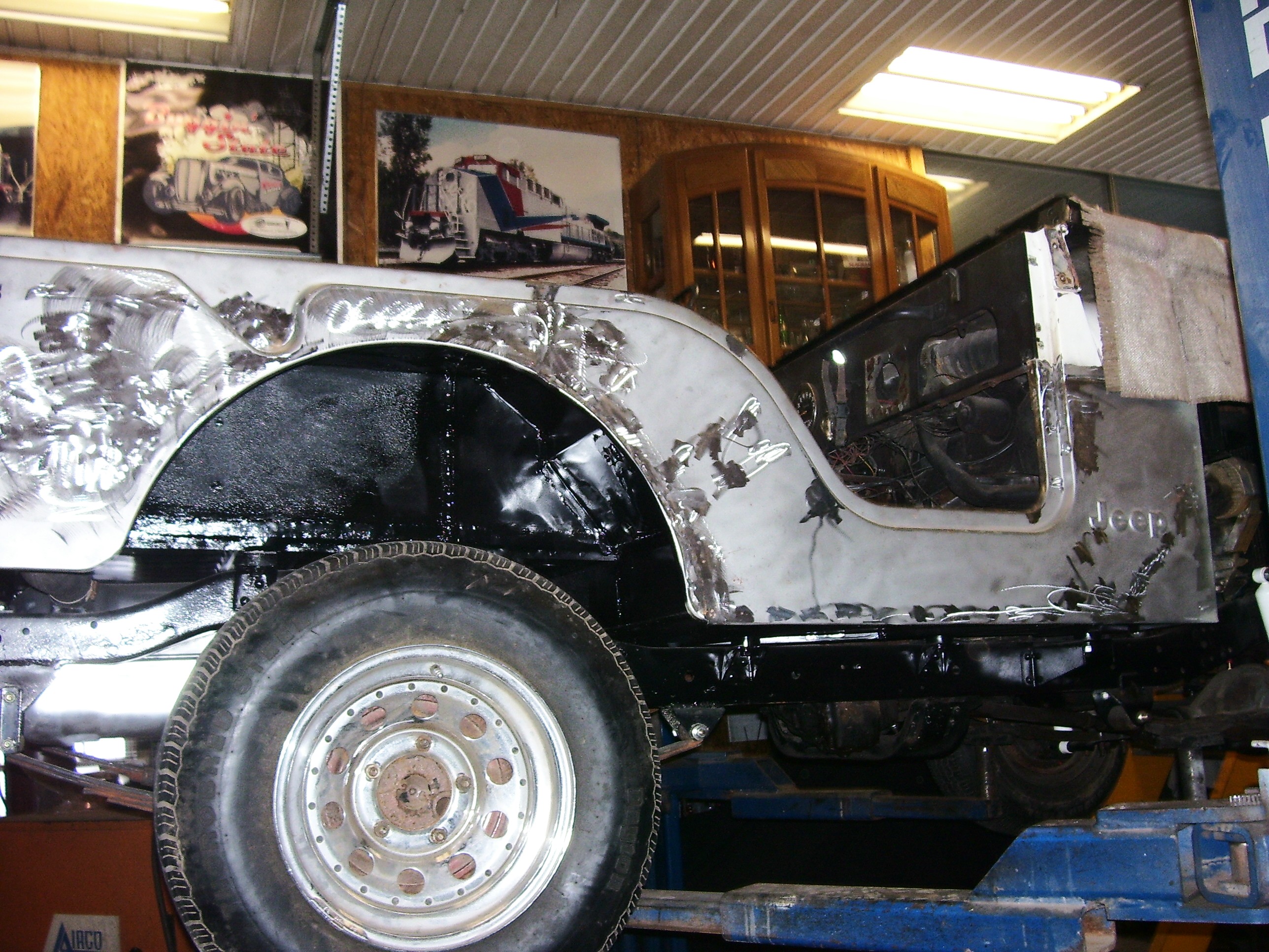

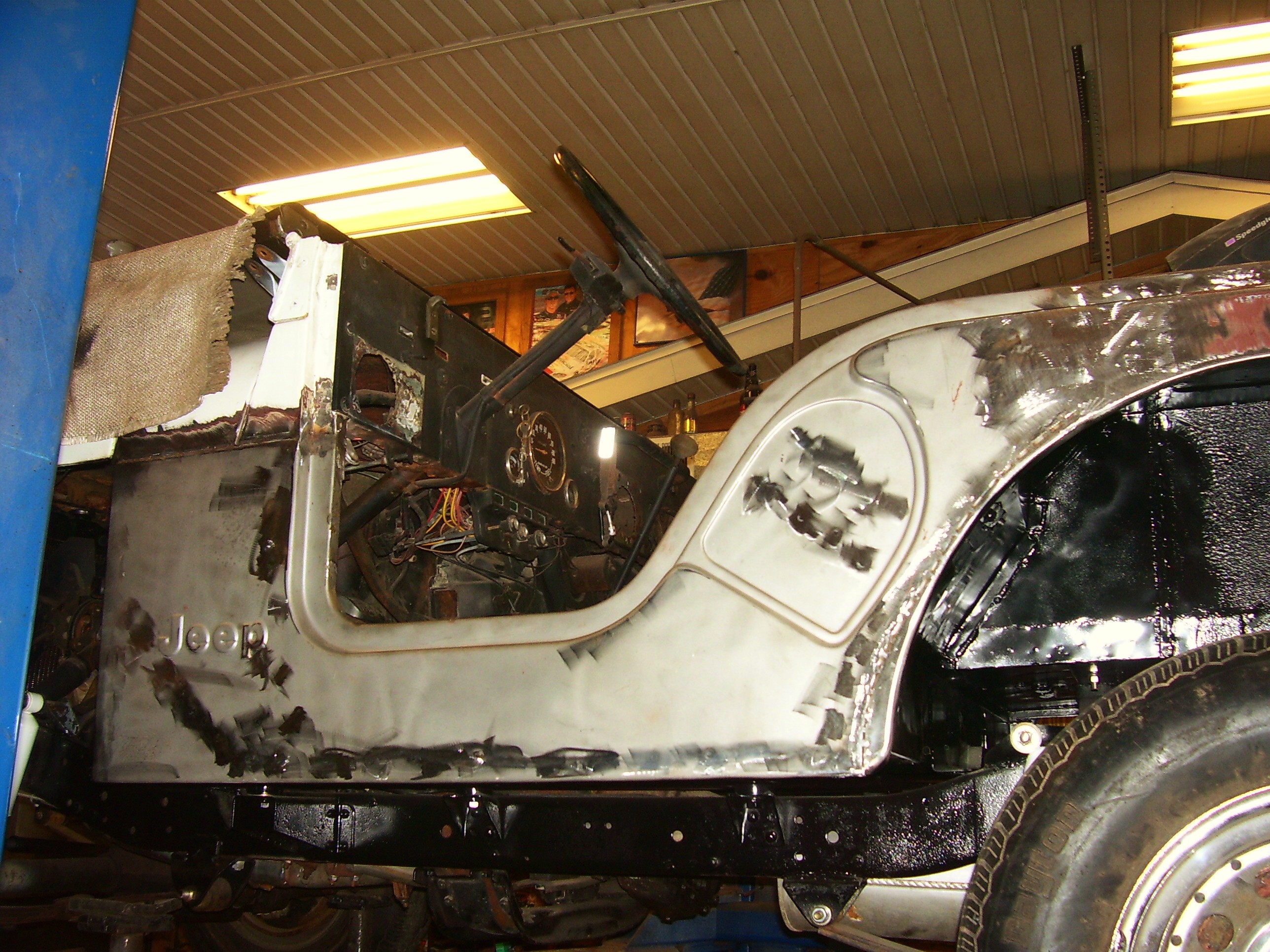

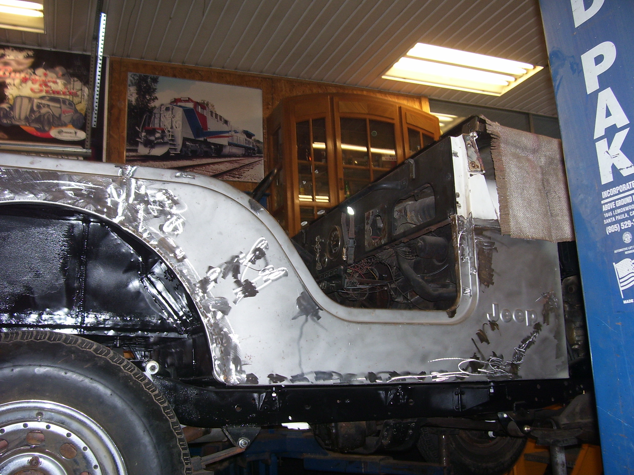

Afew pics of the new panels, SWEETNESS!

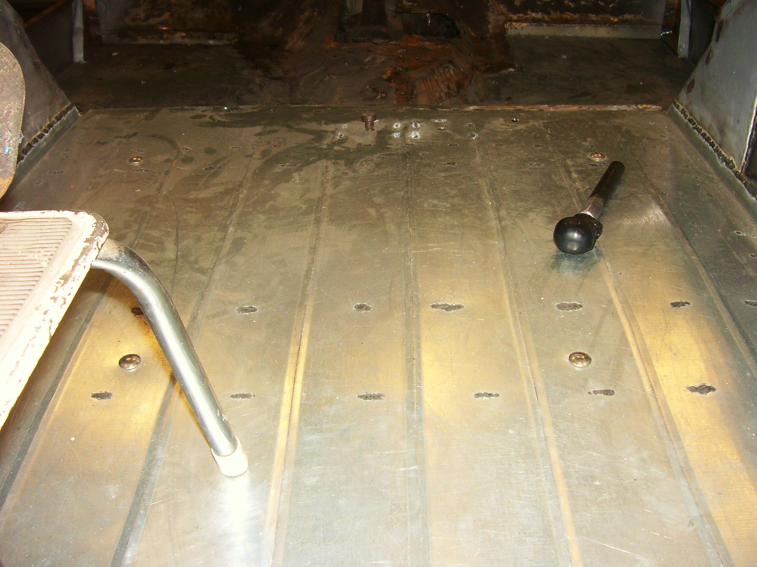

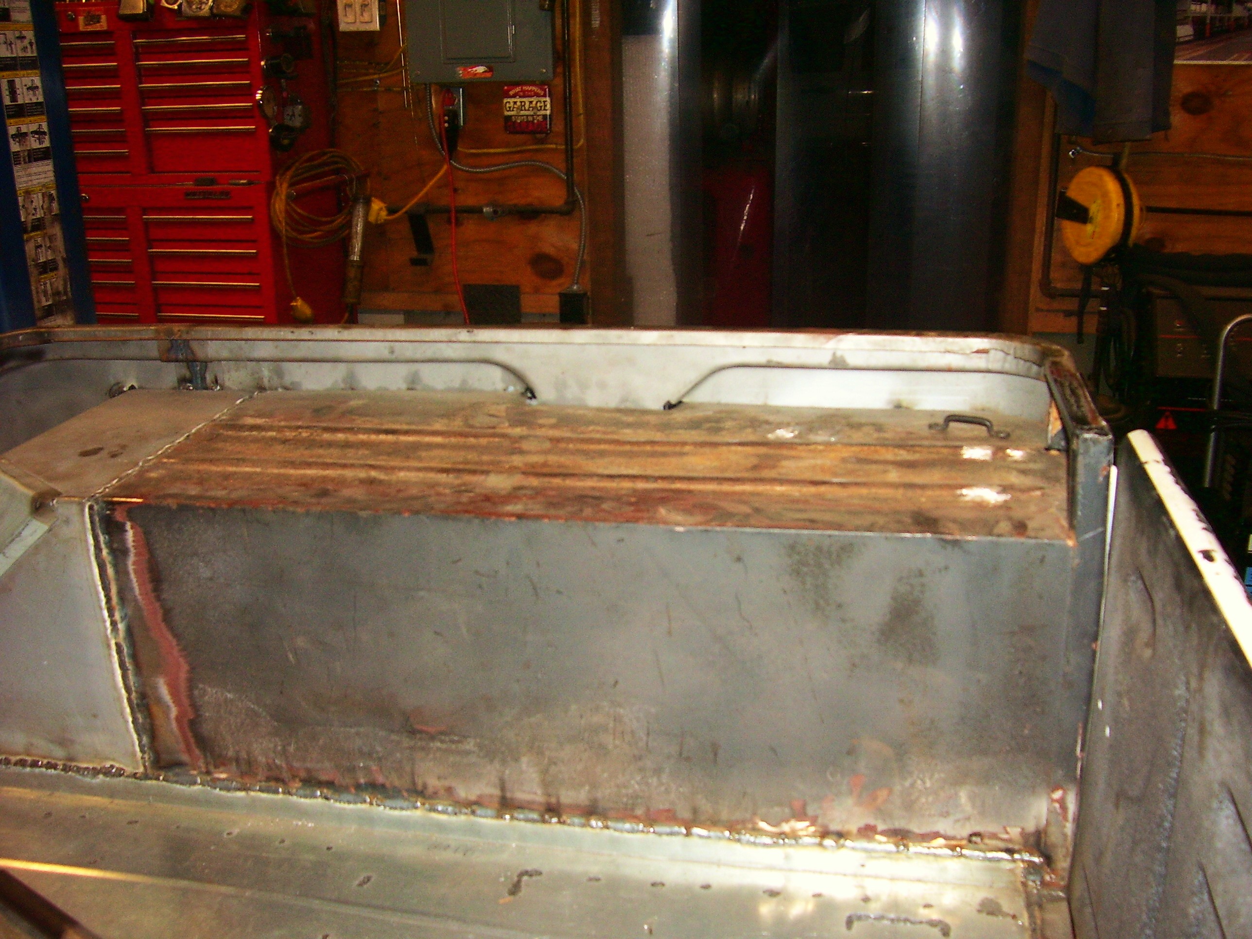

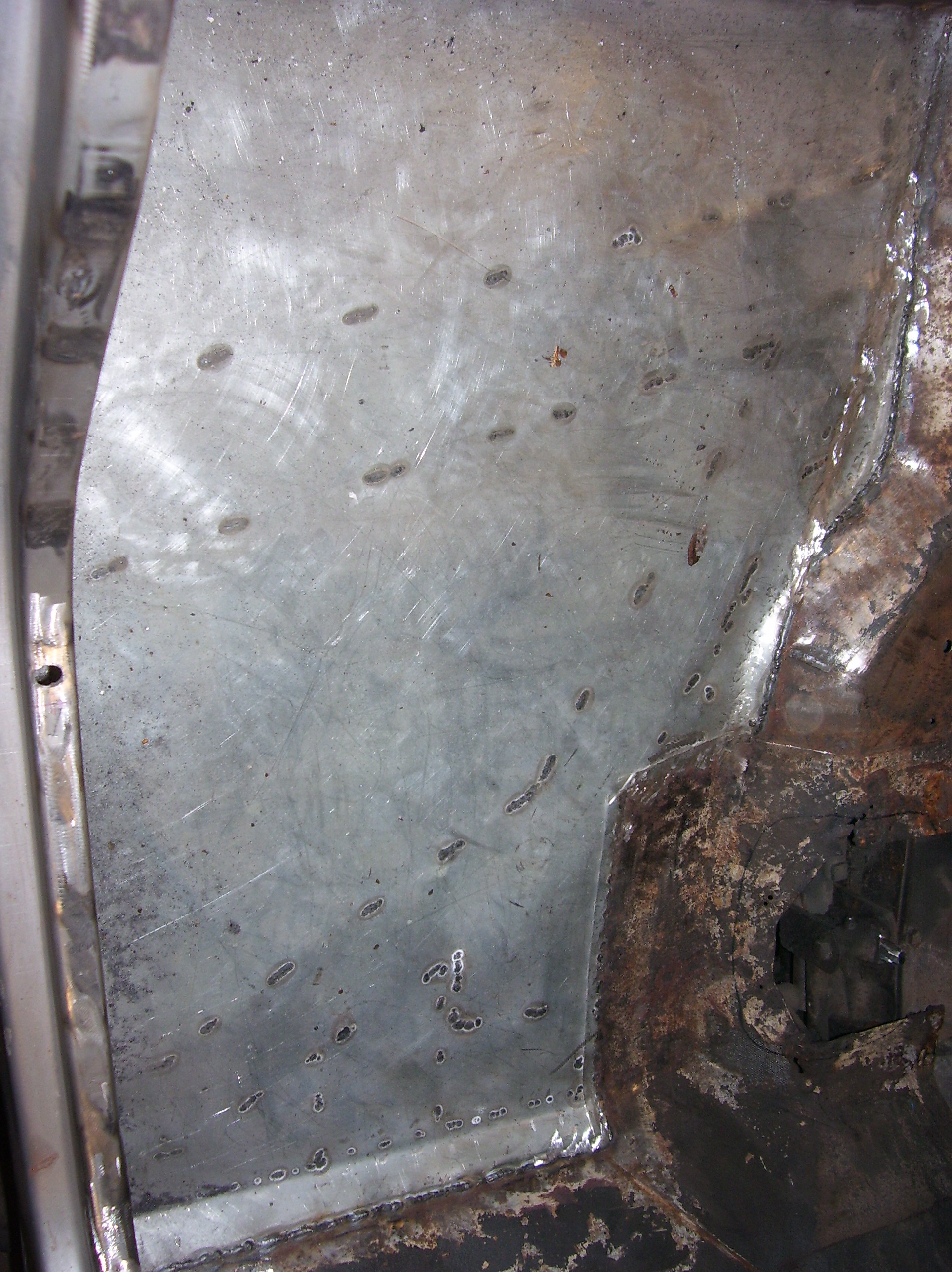

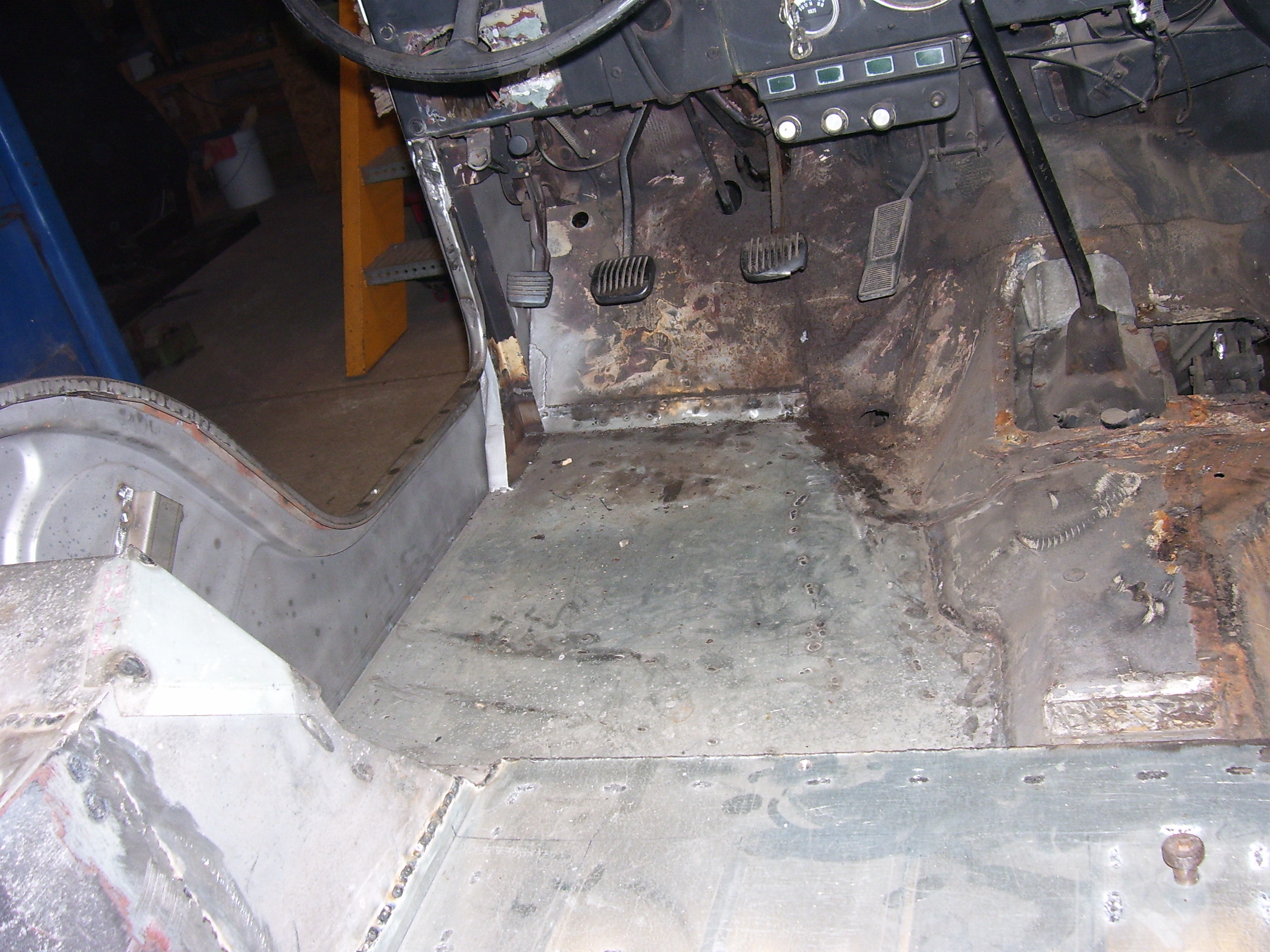

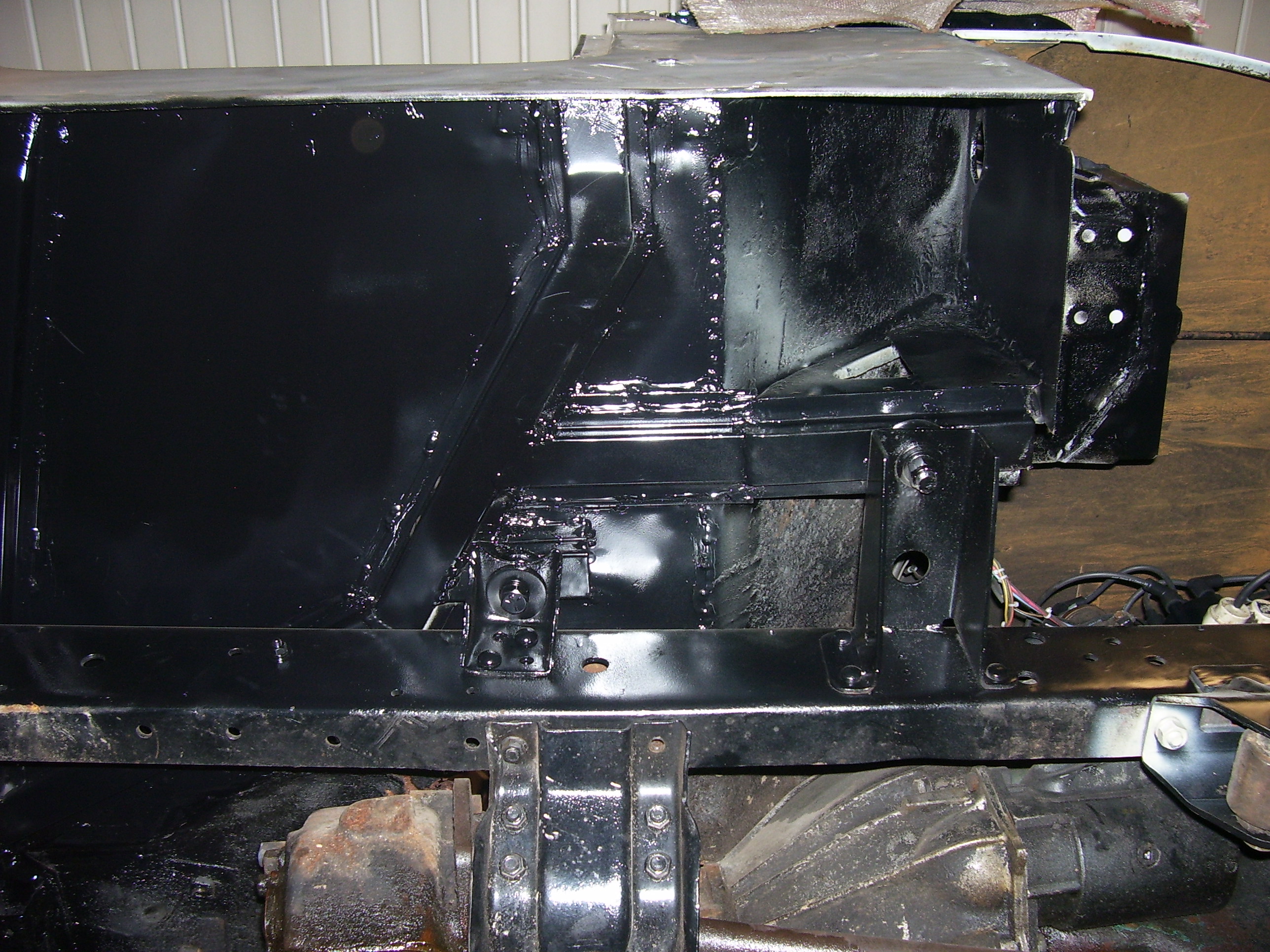

Rear floor was weak, but I hesitated because a relacement was $425. He made one from galvanised steel, and even put the rolls in for me for like a hundred bucks!!!

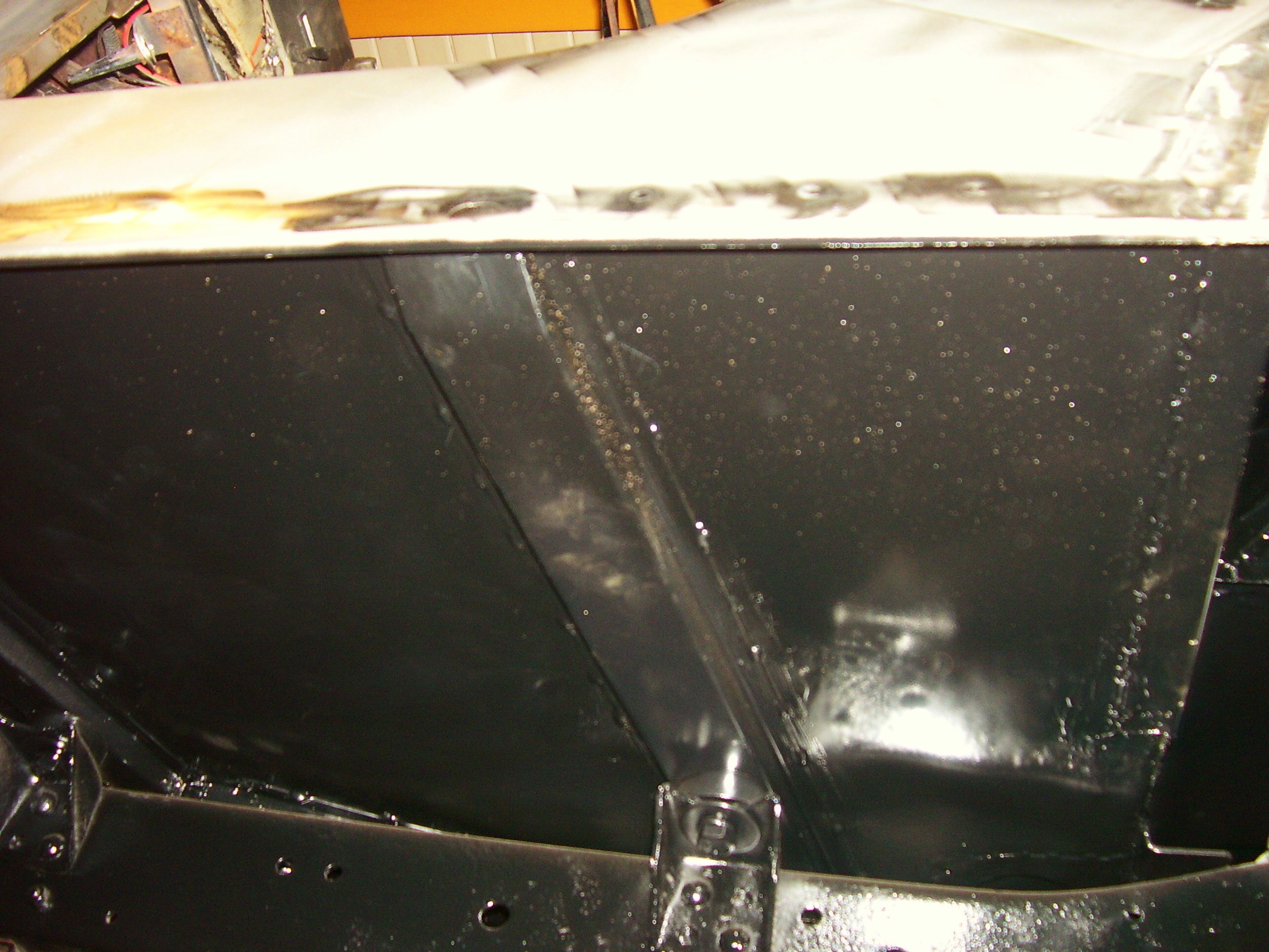

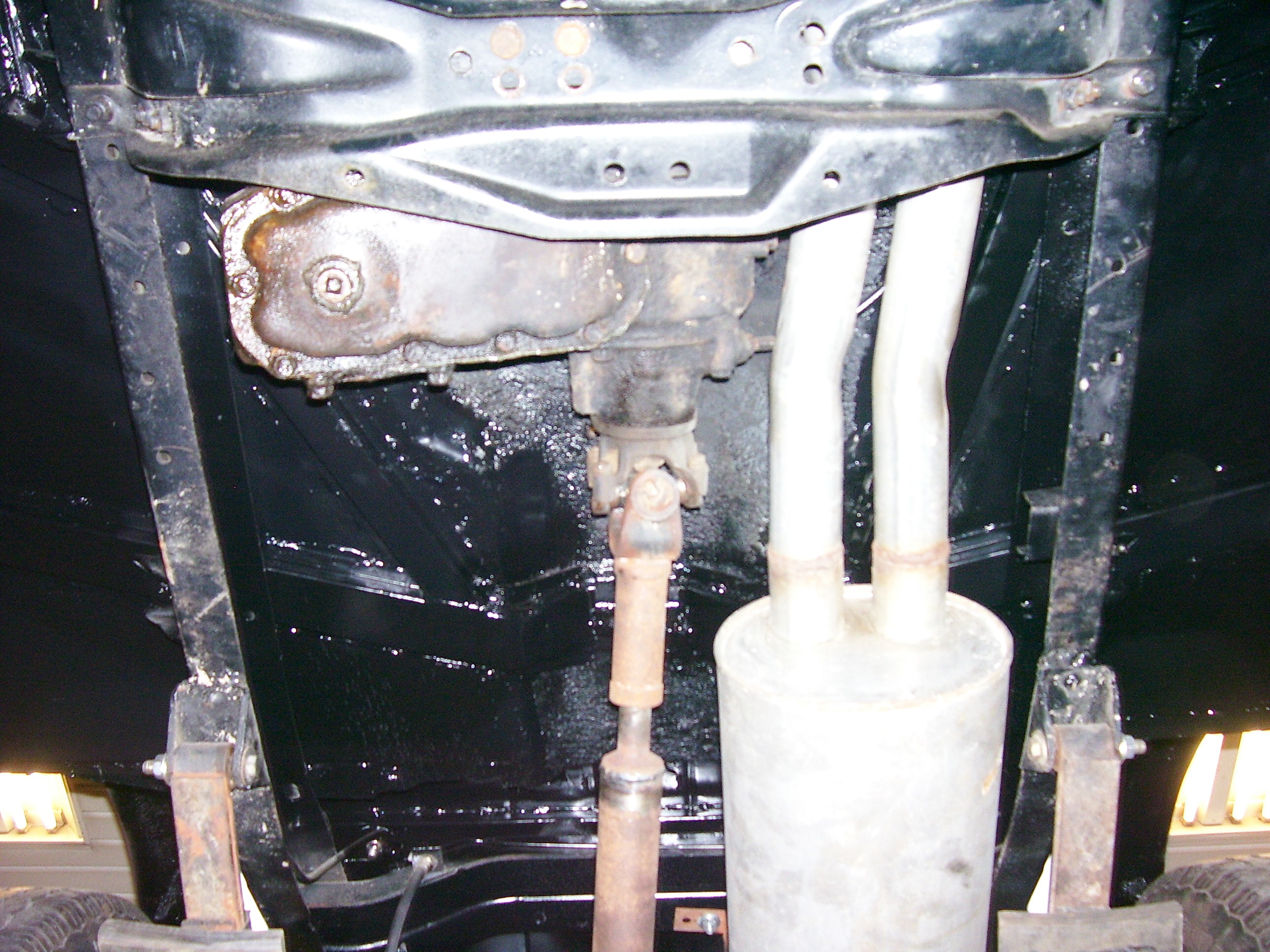

Underside with floor supports, (some bought, some fabbed), and painted with choo choo paint :welder:
Repair to the cowl on drive side where it was kinda yuckified... see the nice smooth new holes to attach the fenders? (happy) He did this on both sides btw.

I will say your using all the good parts and once all the resto work is done to the body , the rest is bolt off and on . That's enough work right there , as you know. I see your point on the frame horns , before I read that part of your post , it caught my attention . If the front axle still sits in the original position , and It looks like it is or the driveshaft and steering linkage and all would have heavy mods as well , the only issue I think would be the effect on the ride , off and on road. Short springs ride harder than longer springs so let's see how it all works out. Once it's done , you'll road test the daylights out of it and you'll have your answer then. Until then , just keep making us proud ! I'll be following your build like your following the electrical thread / wiring harness job . Thanks for sharing your pride and joy with us :welder:! My best , Greg .

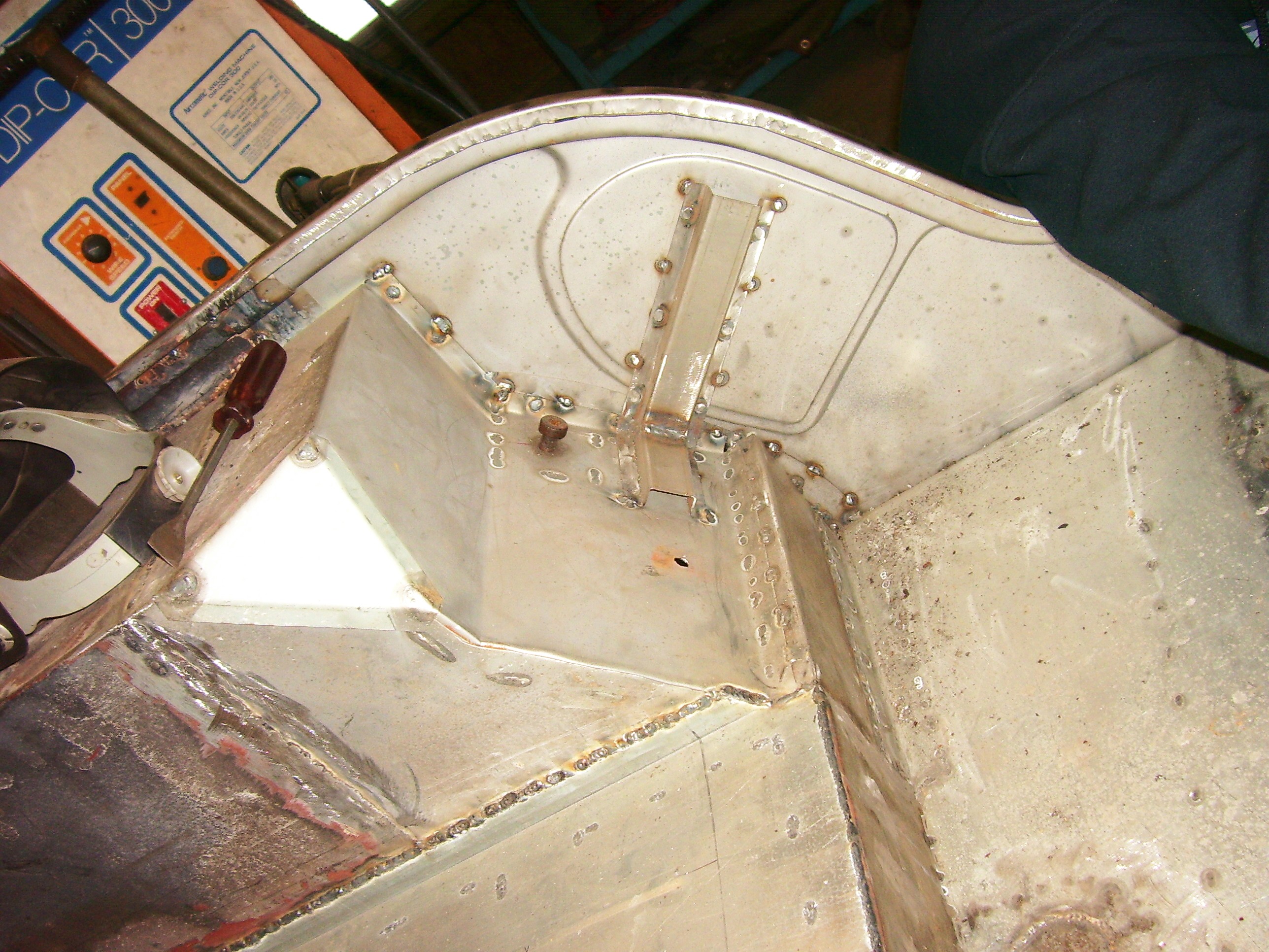

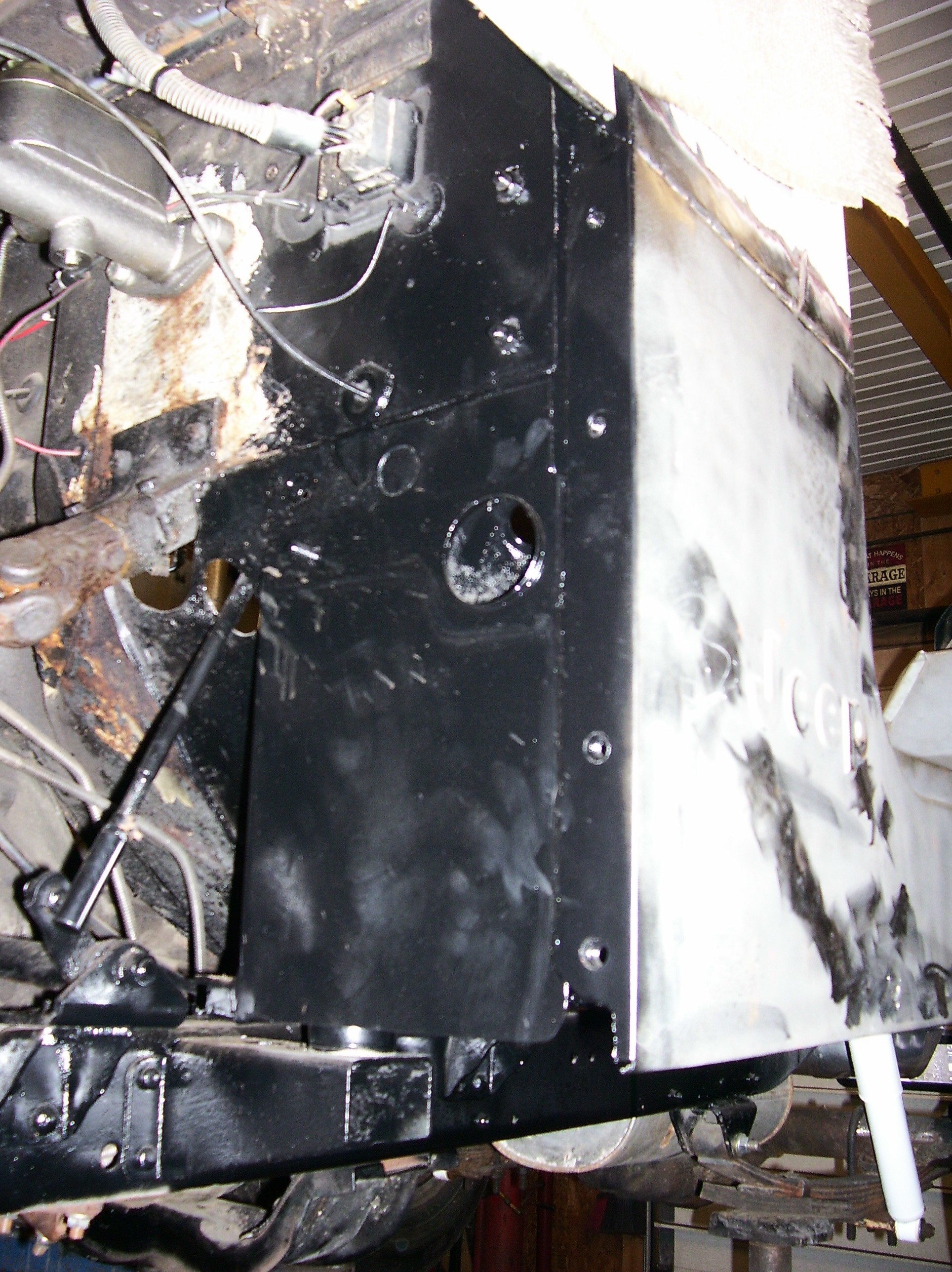

L and R floor pans. Sadly had to part with signature under seat tool box, but it was so mucked up with bondo and an attempted fiberglass job that we just eliminated it altogether. Which also meant fabbing up the seat brackets to reach down to the new floor.
Traded a spare grill for a pair of rear fenderwells that were in good shape. partialy replaced in the bad spots.
In the 2nd pic you can see my transfercse shifter laying on the floor. Yea, that to a gummed up frankenwelded mess (why? no idea!) Made a new one, but its not on yet cause he is repairing that hump area that was poopy.

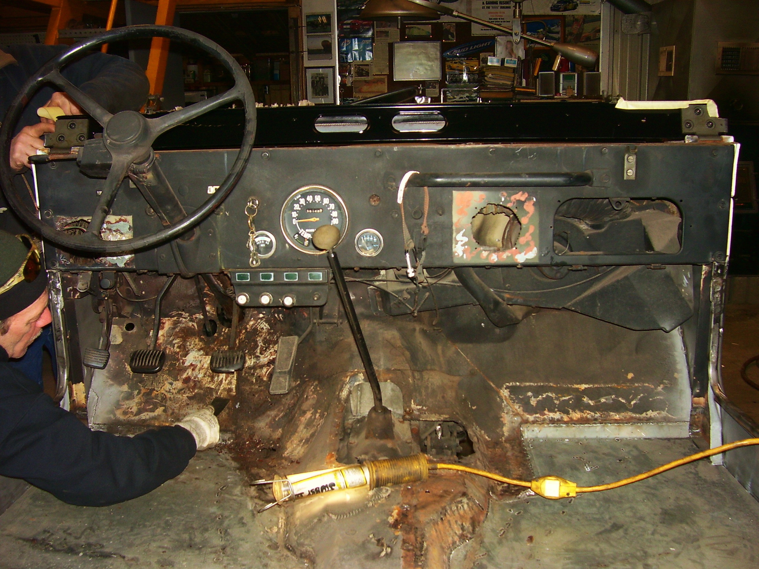

Wow, look how ugly my dash is! Any ideas guys?
You may have already saw quadratechs replacement for $170 , but you'll have to bore out your own holes for gauges , column and all . I'd like to see another members dash if they got an idea for maybe a more modern approach , but that's only if you want to . I like the CJ as they came factory , but that's just me . Might not take too much effort to weld in some patch panels to where someone probably had a speaker on the shotgun side and grind a nd smooth it then prime and paint ?
Man why did/do so many Jeep owners slaughter their dash boards???? wish I had a dime for every one that I've owned/seen that some PO cut a speaker/radio hole in.
The only new replacements I've seen are for newer CJS('76-'85) or with no holes. I think I might try patching that one as greg92jeepxj mentioned....Just my opinion.
On a side note the heater controls look pretty good on that one.
Oh yeah...I almost forgot to mention....you're project is coming along nicely(if not as fast as you'd hoped)....keep on pushin'
Thanks for the support and interest in my build guys! Im pretty excited at this point! I think youre right about repairing the dash, they are impossible to find new, and too much work to drill out yourself. Plus it will be original, which is what im shooting for. Ive seen Jeeps with new stainless dashes, but thats a little too flashy for me. I might be able to put a speaker back in that hole and cover it up? We'll see. Oh I also aquired an original dash pad a couple years ago that is mint! :piratenanner:

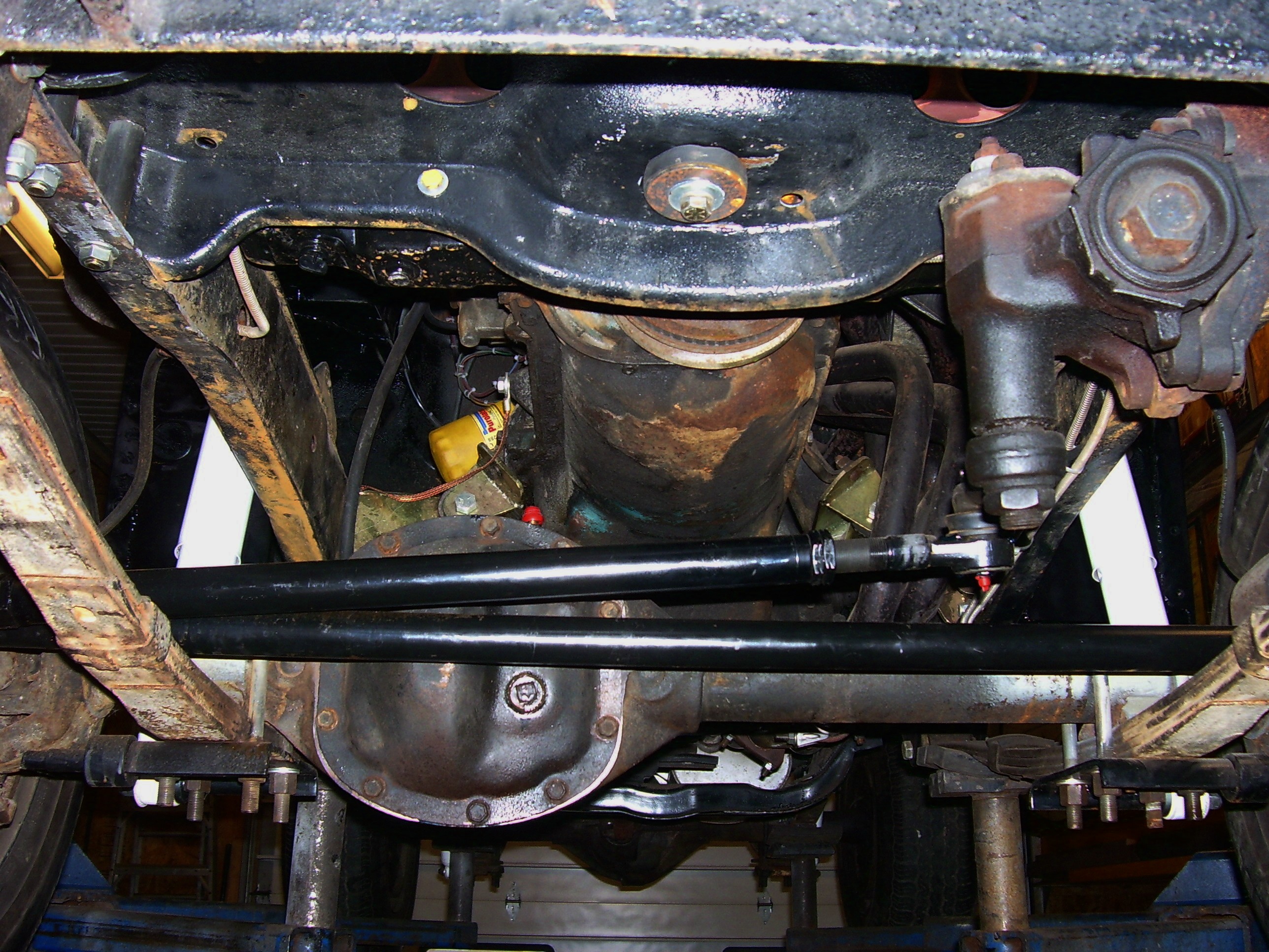

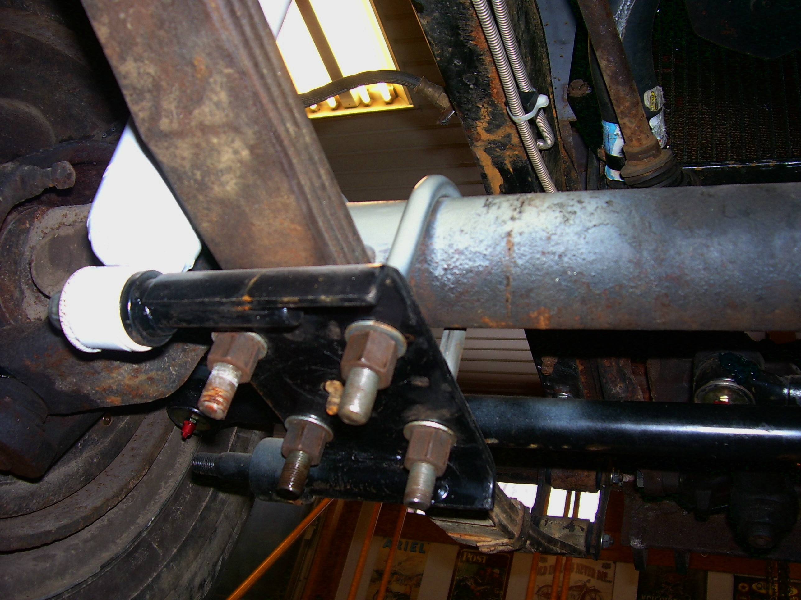

Heavy duty tie rod and drag link. Again, bent up parts that needed replaced due to the half ass soa. Need to make a steering stabilizer to fit it.
