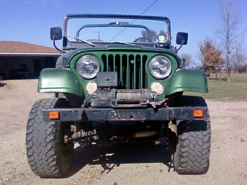

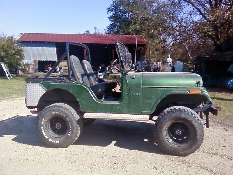

hey ive got a 73 cj5 that my dad got for me when i was 14.. im 21 now an wanna start buildin on it.. im wondering if this is a good jeep to start with or would i be better off gettin a different one.. pro an cons? is it easy to mod? is their much for it? all answers appreciated thanks, Caleb

Welcome Caleb!
Looks like a great Jeep, definately a keeper!
For 75 and down, just a little more challenging to buy parts for, but certainly not impossible.
What engine does it have?
You have a nice classic CJ there. Looks pretty solid, too. Definitely worth fixing up. Looks familiar to me for some reason... Have we seen these photos before??? Best of luck - John

Awesome project,just be ready to spend some MONEY! cj-7 more stable but this one could be fun. Good luck!
The best part about this CJ…. IT’S ALREADY YOURS!!!!! (Any jeep is better than no jeep.)

I would be thinking about boxing the frame first but before you do drop your jeep off at a good frame shop and have them straighten it out and then do the work right away before it moves again on you. It could just be the picture and how the jeep was sitting on the ground but it looks to me like the front end sits up a little bit.
