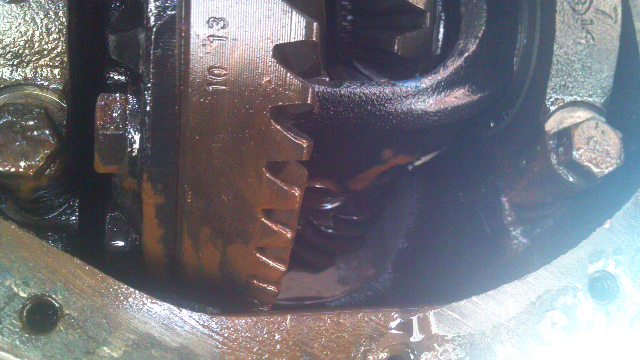

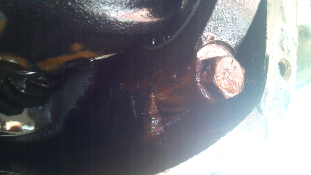

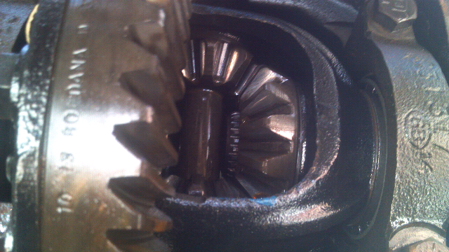

Ok and not yet starter needs to be replaced. Waiting on shipment. In the mean time took the front axle housing off. Everything looks fine. Just alot of sluge. Will post pics soon
Looks pretty good.
