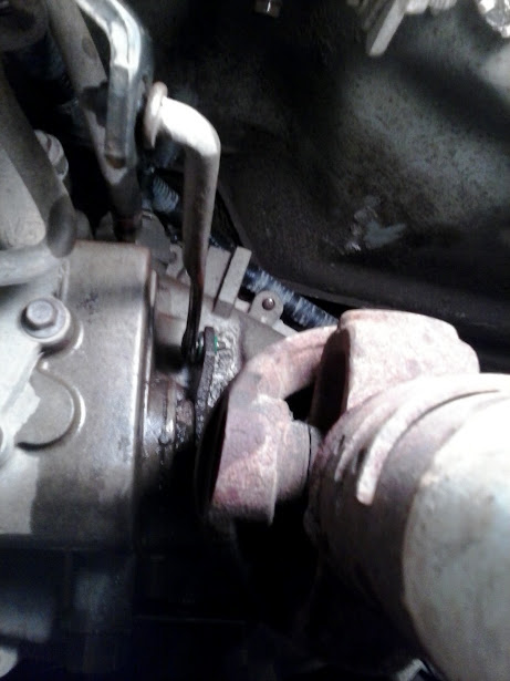

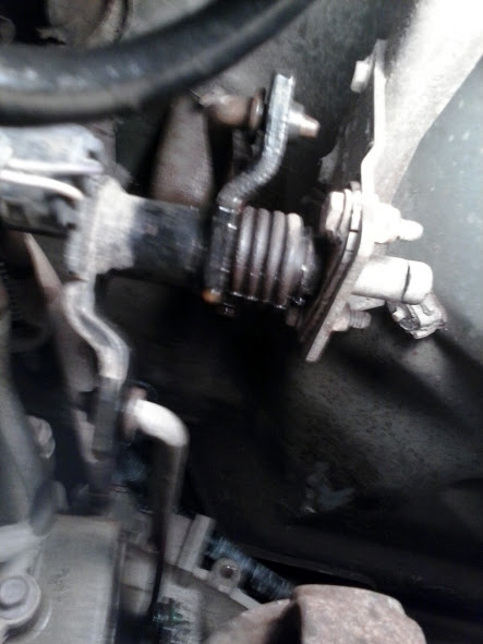

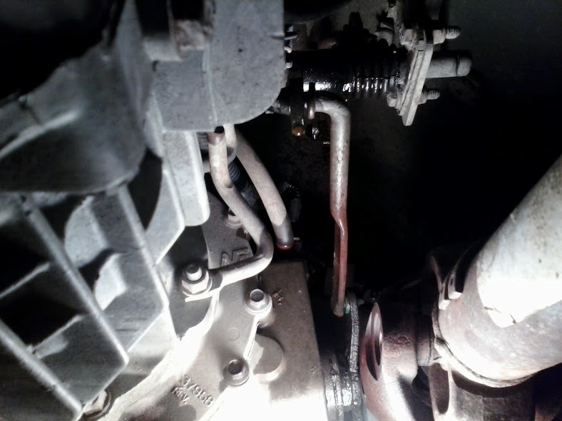

If attached pics of the shift linkage. if anyone has ideas on how to adjust this so its more like it should be let me know.

You likely have a small body lift, 1"-2", and the remainder of your lift is suspension lift. The good news is they put a drop bracket on the tub side of the transfer case linkage, so that part is done correctly.
There should be an adjustment nut on the lever side of the transfer case linkage, loosen it to allow the shift rod to slide through the adjustment hole. Once nice and loose, put the transfer case in 4lo by hand. Then move the shifter to 4lo and tighten the adjustment nut.

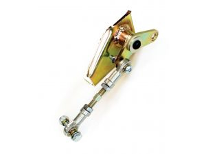

My transfer case keep popping out, the fixed it. Teraflex **** linkage bracket. Mounts to the transfer case only. Works great now.
