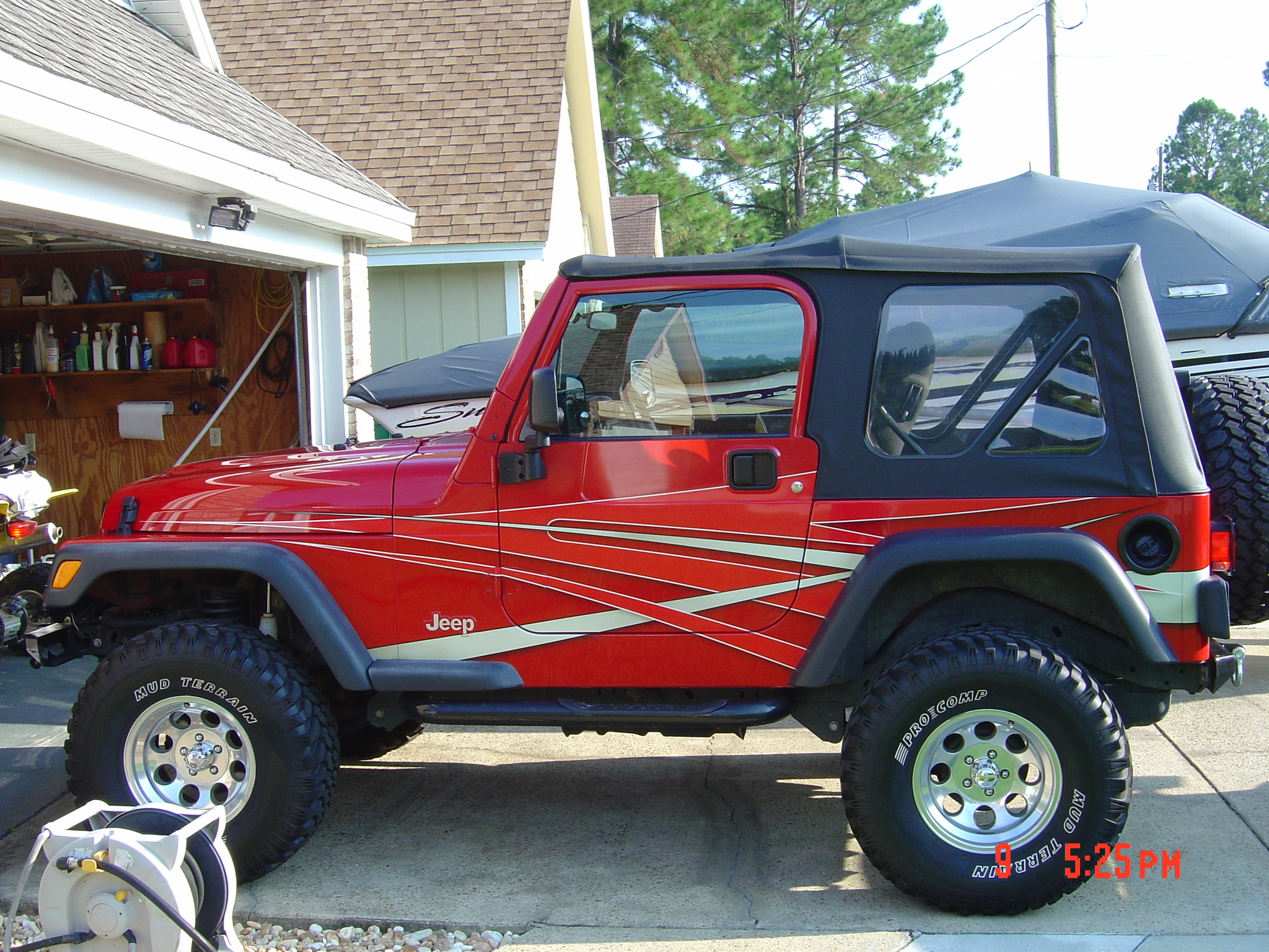

My 2003 TJ has a 4" lift, nothing special, and 33 12.50 12's. I would like to get another 2" for a total of 6... what would be the best way to do this.. I dont want to spend a ton of money.. Could i do the rubber spacers on top of springs? 2" body lift??
The jeep does not have ADJ. track bars, and no SYE kit either.. Also what would be the cons by adding another 2"s, I have 3.73 gears in the rear, and i have the 4.0??? lets hear some thoughts, ideas, pro's cons, etc... thanks in advance

I dont do much offroading as you can tell in the pix, Im not a big fan of tearing up my vehicles, specially something with alot of money in it.. As for the lift i would just like to have about 6" under me, 4" seems normal and everyone has them, so alittle taller would be better..

I dont plan on going bigger than 35's, and i probably wont even do that until my current pro comp's 33's wear down to nothing, i just wanted the jeep a bit taller, and im pretty sure if i get 35's on my 4" now they'll rub...
rub I have a 2 inch lift on my flatie with 35s and my wheel base is way shorter than yours with 4 inch those 35 will be swimming in there since thell be alot of clearence

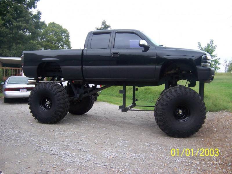

OR is this the look your going for
