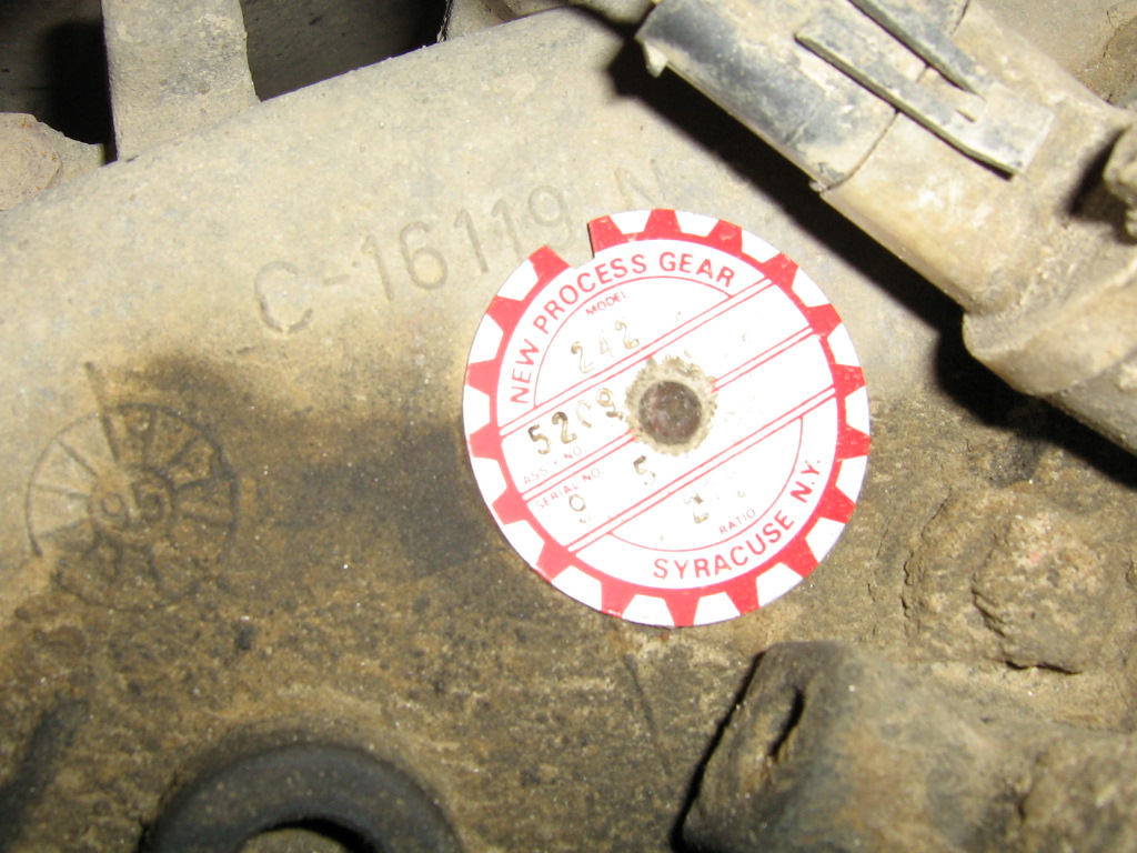

I removed the front drive shaft. The U joints seam ok, no play or stiffness. So I took it for a drive with the shaft out. No roar no vibration??? So I thought I would drop it in 4WD and see if the roar was there. Not as heavy until I got two snaps like a chain jumping?? so I put it 2WD and it drives ok again. Oh it is a 242 case.

case is a 242. that is what the tag says. Anyway my 4WD is a 2WD until I get another case.

That's new to me. I looked at the E-FSM for the 4.0 and 5.2 V8 and neither had a 242 optionon on the 96 model GC:???:. 242 is on the 97 GC models thou. I wonder if this is another one of those mid year change over on the build date.
A 231 in a grand cherokee is fairly rare. And if I'm not mistaken...was only an option in 93 but I'm not 100% on that. Most of them either have a 242 or 249. If you have the V8 you more than likely have the 249 if I had to guess. Try and do some figure 8's in a parking lot (w/ your front drive shaft installed). If it's your VC...you'll feel it jerk as it's binding up. I wouldn't rebuild it...either swap in another 249 w/ a good VC or swap in a 242 or 231 like previously said.
It is a 242 or so the tag is marked. The jeep is a 96 build date 9-95 . The transfer select has 2WD- 4W part time- 4W full time- N- 4W low part time. When the shaft was in in a tight turn in 2WD I could feel the climbing of the front end. Now with the front shaft out it like driving a diff vehicle.

I wouldn't recommend a replacement 249 to somebody I didn't like. Check your local Craigslist, 231's and 242's are pretty commonly available. Trick would be finding one with the correct input shaft unless you're willing to swap in your current input shaft.
