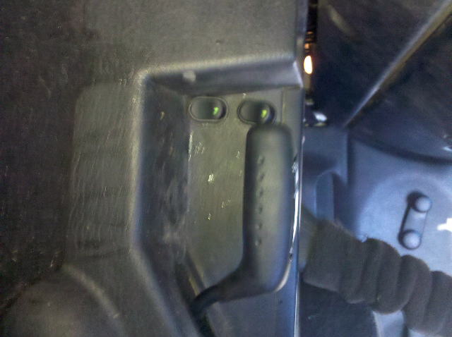

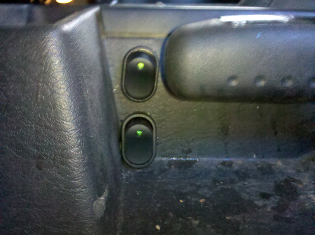

Ive got 4 kc daylighter 100w long distance lights and ive got them wired similar to tjlboise, except i have in-line fuses. I do not have them wired to a relay. Im not sure what the relay does specifically. Could somebody explain that? And i like the idea of a ground side switch so no live wires are in cab. But my switches came with the lights, and have leds on them so require power (not require for switch and lights to work, just for led to work) i just went with the diagram that came with the lights. Grounded each light right next to the light itself with the supplied self tapper pan head, ran the positive wires to eachother, then to the switch. Ran the load wire off the switch to the in line fuse which is near the battery, then to the battery. The switch itself is also grounded. They work like a charm. I also didnt like the mounts it came with so i drilled a hole in the plastic center peice next to the t case shifter.litte cleaner i think, and out of the way. Like tjlboise said tho, im no electric master. So be careful.
