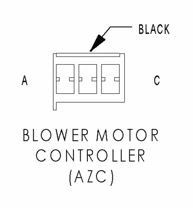

The controller is mounted to the HVAC housing, under the instrument panel and just inboard of the blower motor, in the same location used for the blower motor resistor on manual temperature control systems. It can be accessed without removing any other components. The best way to test this system (AZC) is with a Multimeter. when the blower is inop, wiggle the blower motor connector and see if the blower kicks on. if it does, disconnect the connector and inspect the terminals for heat damage. if it passes inspection, then the blower motor is more likely to be at fault. If it does not kick on, test the circuit for voltage. if the AZC is set at Full, then the Voltage should be close or at Battery voltage. The blower motor controller adjusts the battery feed voltage to the blower motor, based upon an input from the blower motor switch, through the AZC control module. Pulse width modulation of blower power allows the blower to operate at any speed from stationary, to full speed. so with this in mind, the voltage you will see on the Multimeter may vary from 0 to 12 volts. this would not mean that the blower controller is at fault unless the AZC blower setting is set on high. Perform this test , if you dont locate the problem, let us know so we can do some more Diagnostics on the circuits.
BLOWER MOTOR CONTROLLER (AZC) - BLACK 3 WAY
CAVCIRCUITFUNCTIONAZ118 12BKGROUNDBC56 20RD/LGBLOWER MOTOR CONTROLCC1 12DGBLOWER MOTOR SUPPLY
