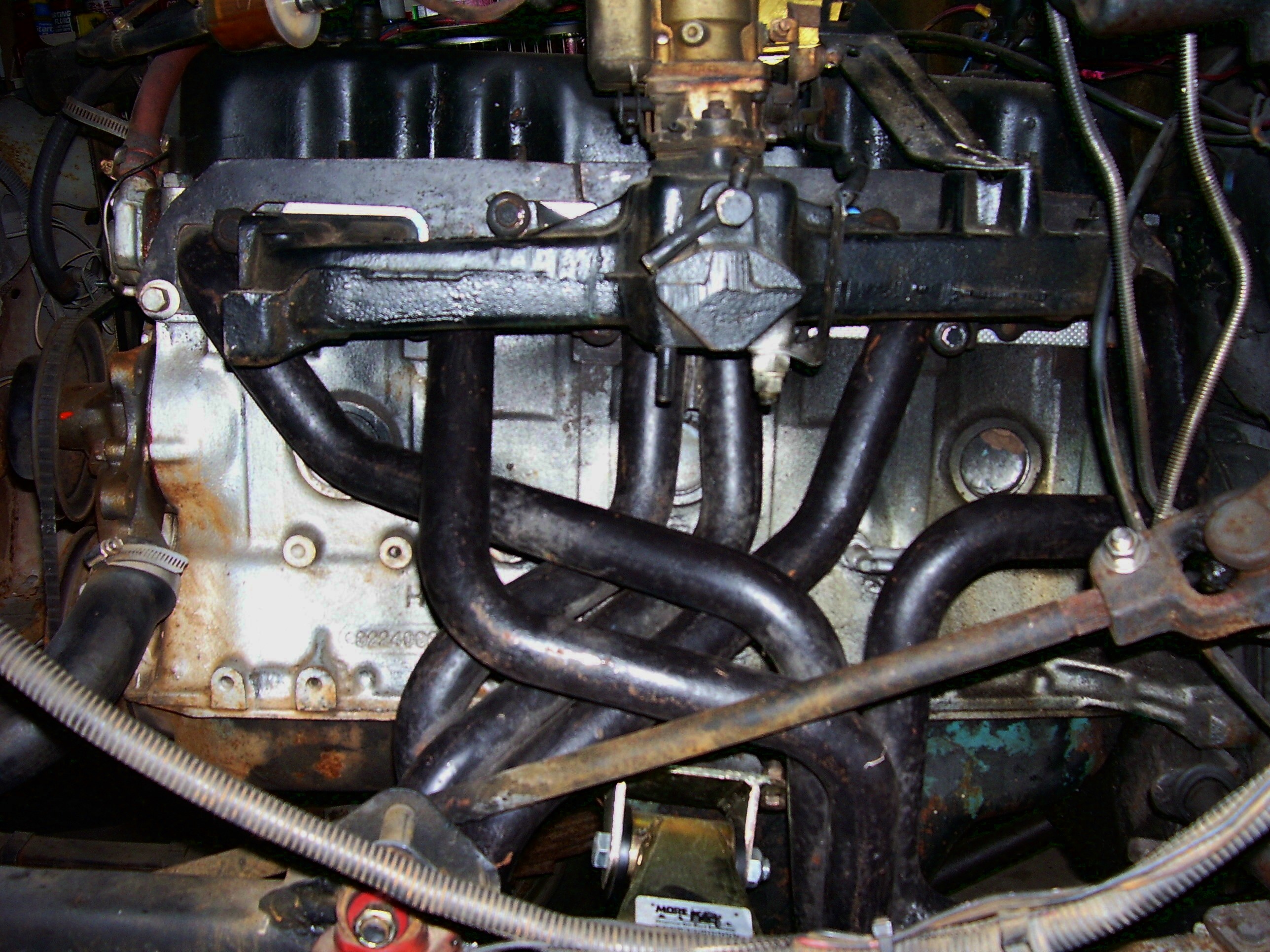

Had to replace entire exhaust due to the lift being too high and the steer arm wore a hole in the old headers. Remaining exhaust was welded on and had to be cut off. All repaired correctly.
