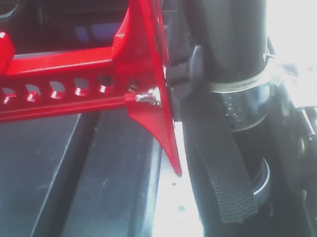

I went with cyclone fence clamps after reading several posts here and on the Jeep Forum site, these 2" clamps hold fast and with the rubber strips for extra adhesion should last a spell. Way cheaper than the Hi Lift accessory mounts.
