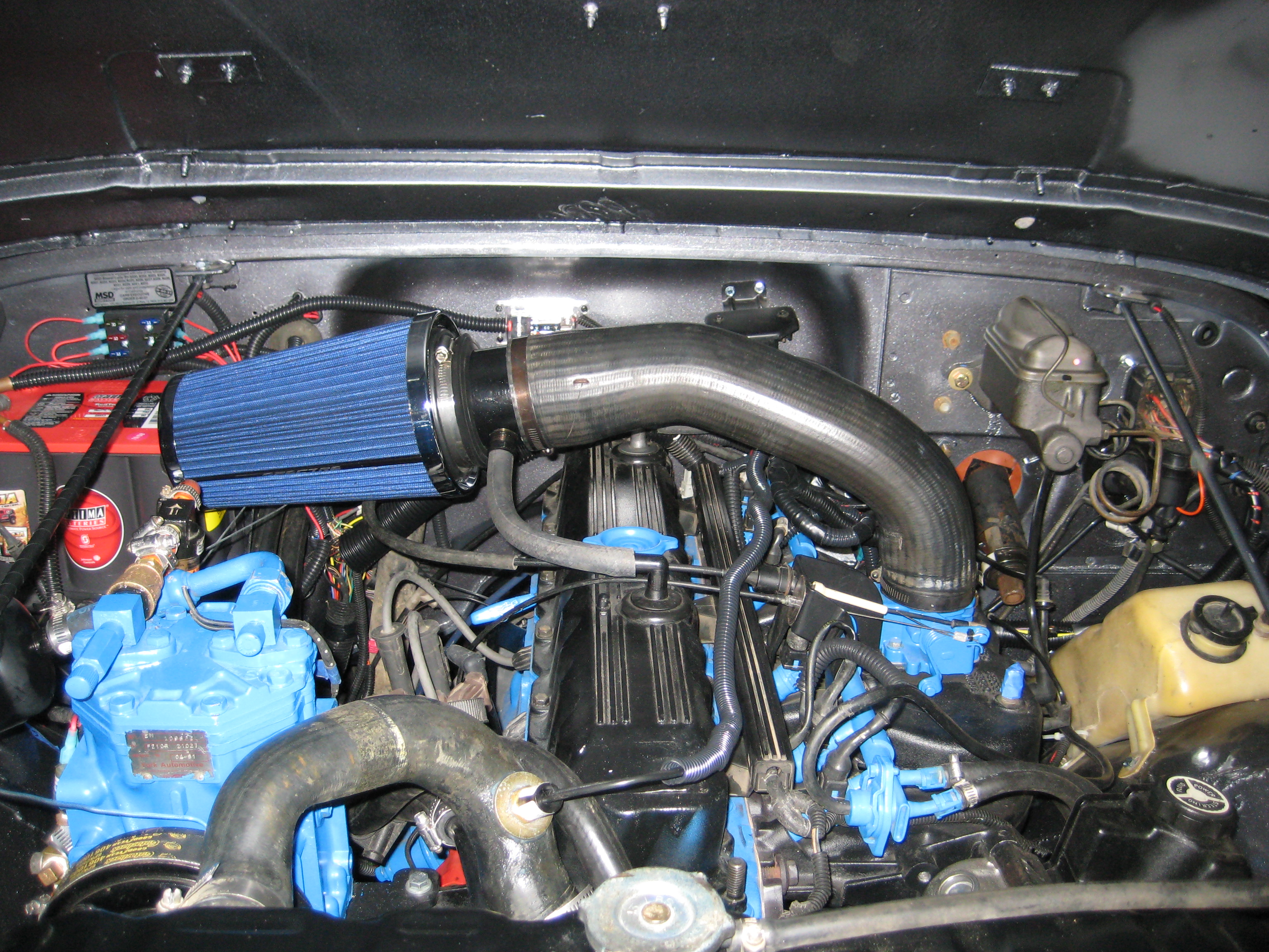

4.6L stroker w/OBA
  • Media owner GaryMB
bored .030, 258 crank, dished pistons, crane truck cam, 2001 intake manifold, Borla header, cloyes double roller timing chain, 24lb/hr injectors, adjustable MAP sensor, York 210 compressor, flowkooler water pump, flexalite dual electric fans, 185amp alternator, fuel: 87 octane CR: ~9.3 hp/torque: en
