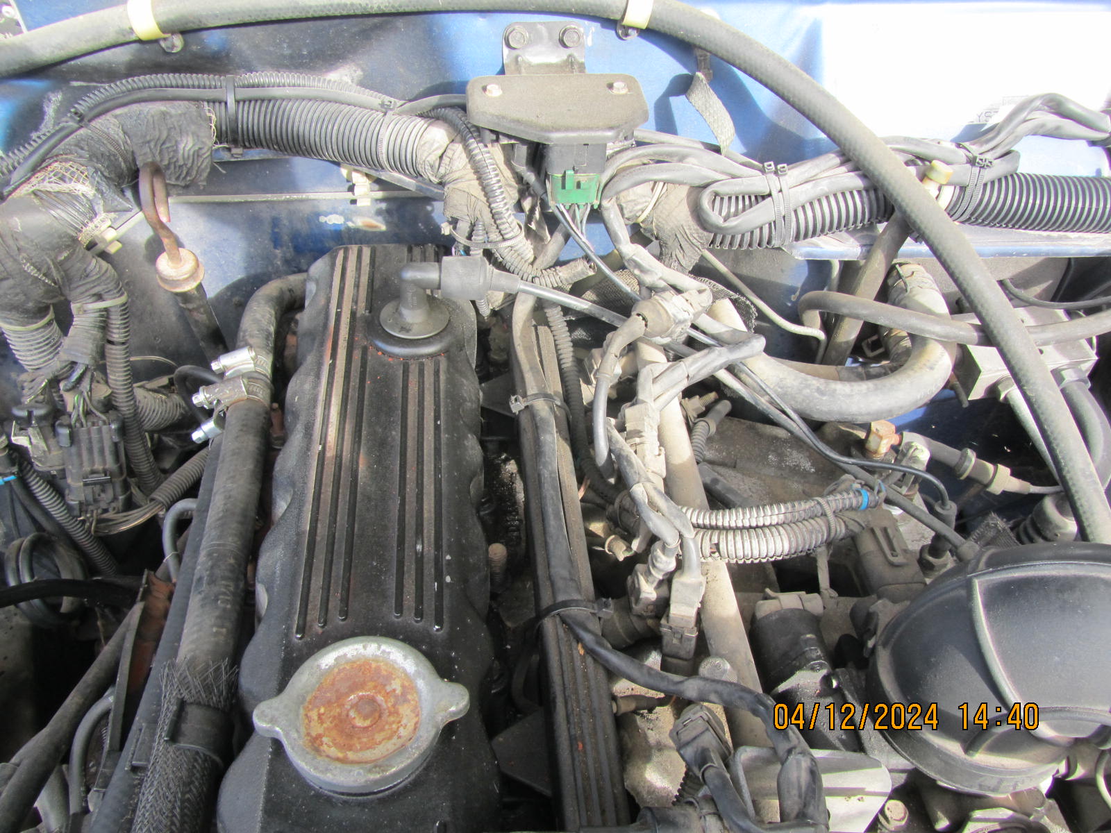

I am trying to find the moulded heater hoses for my 1994 lit XJ. My usual ports of call for things Jeep have drawn blanks and Mopar says discontinued. I am not sure I can get preformed bends and make them up myself in the local area.
For reference, they exit the bulkhead forwards from the heater matrix ( I don't think it has valves) then double back on themselves, go round the back of the rocker box then turn 90 deg to the water pump on the opposite side of the engine.
Sadly one failed the other day and I lost all the water on the test house floor. I was politely shown the door.
A little hard for me to tell from the pics but what I did with my 1990 XJ was keep the hard pipe and use regular heater hose for the short flexible parts.

The only hard pipe I have are the two short stubs poking through the bulkhead (firewall) that your hoses fit onto. There is no water valve, so the water circulates all the time.
Sorry if the pics are not that clear but there is a lot of other stuff going on in that area which I why I marked them up to try to help.
The straight bits are no problem but it's all those twists and turns at the back of the engine. I can't find anyone who keeps a range of preformed rubber elbows and bends that I can simply join together like you would for an exhaust pipe.

I have attached another pic and a sketch of what the hose should look like. This is a RHD car.

That does indeed look very close to what I'm after.. My set up does not have any valves or vacuum lines and the coolant flows through the core at all times.

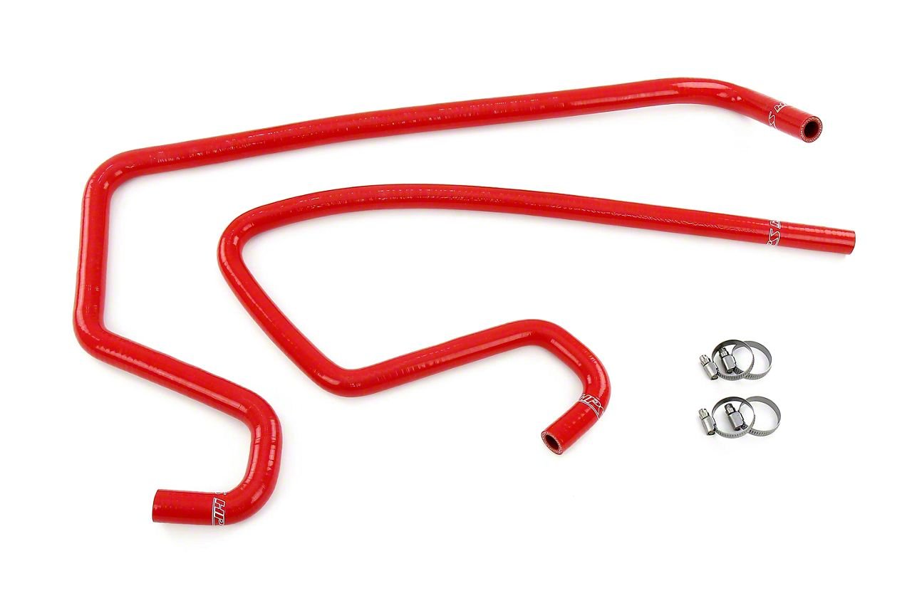

Are these it in amazon?
What a weird link it made. I tried again here:
Hmm, thats odd
Thanks for this. Sadly they are not what I am looking for. This is a far more complex set up with crimped metal pipes.
My needs are much more basic, just plain rubber tube with preformed bends to wrap round the back of the block.

those are on the left hand drive jeep cherokees, grand cherokees, and wranglers. they get brittle with age and break when you try and move the hose around a bit to do anything on that side of the engine. i think that is why its hard to find the rhd hoses, since it doesn't seem to be used on the rhd jeeps. i was going to comment on that valve and possibly using the lhd hoses last night but i forgot while i was searching before bed.
reading through more forum posts, it seems everyone has gone to the silicon lines, or used pieced together lines clamped to bits of copper pipe
